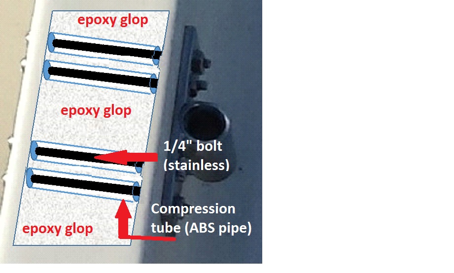

Next, a picture showing placement of the oarlocks in line with the main swivel, and placement of the seat just aft of the jib cams. The seats are removable, but in fact, we leave them bolted in place all the time:
Finally, a detail of the photo above, illustrating the oarlock reinforcement. After drilling holes for the oarlock bolts, I placed compression tubes inside the coaming so the bolts wouldn't crush the fiberglass when the nuts were tightened. The tubes were cut from heavy electrical conduit. I also glopped epoxy putty around the tubes to further reinforce the hull, but that may have been unnecessary and needless weight.

If so, maybe you could use what's called a "top socket." The fitting consists of a metal plate that mounts flat to the deck, with a well that goes below the deck and accepts the oarlock shaft. (What I have in the picture is a side socket. There are also edge sockets that mount on the corner of the gunwale.)
You would still cut an inspection port in the vertical side of the cockpit to see what's in there and to reinforce the oarlock. Also, you would need to use the inspection port if you wanted to anchor the shaft of the oarlock with a cotter pin. And you would have to plug the socket while sailing to keep water from getting into the bilge.
