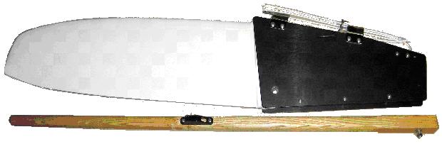

Postby IslandFarmer » Thu Apr 22, 2021 1:44 pm
Like this one?
dr132 Rudder & Tiller DS II & III.jpg (16.73 KiB) Viewed 10031 times
Sorry, just want to be clear we're talking about the same thing. (Rudy is selling two different tillers.)

Postby jalmeida51 » Thu Apr 22, 2021 3:09 pm
My tiller is for a Daysailer1 and ISN'T the same tiller you have.
