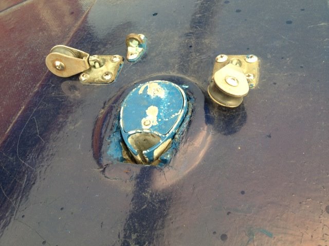

This is my original set-up.

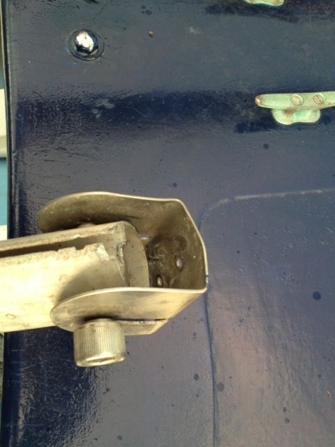

Postby waterbug » Tue Jun 23, 2015 10:28 am
And here's my new mast, slightly different dimensions, 2 5/8" x 2 7/8".

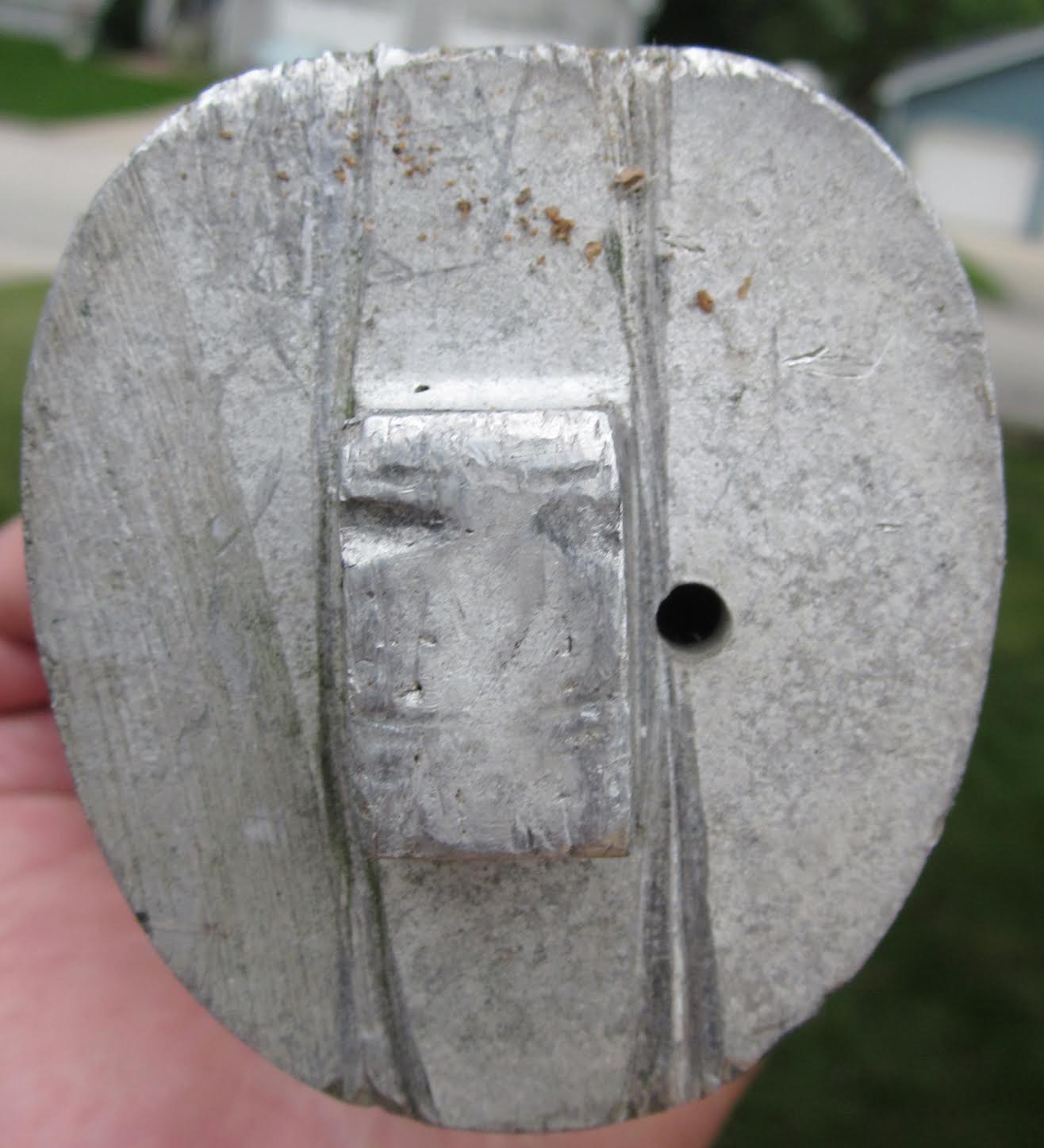

Postby UCanoe_2 » Sun Jun 28, 2015 12:37 pm
Waterbug, if your new mast does not exactly match your old fittings, you may be able to make an aluminum adapter:
1643
1642
My replacement mast was slightly larger than the original. I drilled and tapped for machine screws, filled the gaps with 3M 5200, and screwed everything together. You could use epoxy instead of 5200. Using plastic shims (old milk jugs) and teflon thread sealer between aluminum and stainless steel parts will help prevent corrosion.
1641
Here's what mine looks like assembled. The black stuff is Poor Man's Layout Dye, a.k.a. magic marker. Comes right off with denatured alcohol.
1644
