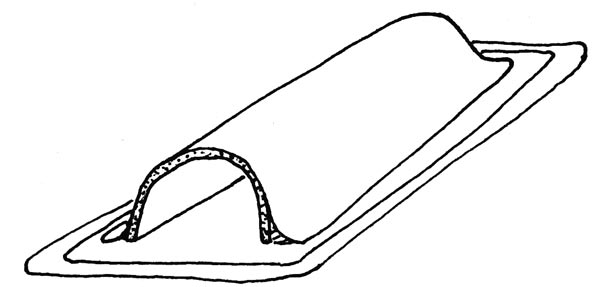

The stringers I would laminate on a work table. Two layers of cloth one narrower than the other as a base. Then something hollow like half of a paper towel roll. Bend over the edges or use some fillet material to make a rounded transition. Then cover with two layers of cloth, again one narrower than the other (to provide something like a soft transition - I didn't try to draw them separately). If you find this too flexible when it's done, add another layer of cloth over the hollow part.
Because the hull should basically be flat in those areas, laying up the stringers separately like this should work - depends on how well you can pull the hull back into a flat shape. Trying to laminate it in place would be much harder.
Then fit in place, glue with epoxy, and lightly wedge against the inner hull with foam until cured.
I'm suggesting a hollow shape so that these cannot retain water.
To fill the access holes, I would laminate a bit of a flat plate (3-4 layers of cloth) on a work table first and tapering the joints on both hull and plate glue that in. If the area is slightly hollow still after the repair, you'd have room to fit a final layer of glass over the repair from the outside.

If your indentations are deep enough, then simply using a spacer material and adding a new, flat, layer of glass will give you the effect of a sandwich. The strength of a sandwich comes from having two layers of laminate separated by some distance. Relatively minor separation will have a noticeable effect. Fairing compound may be too expensive (and too heavy) as a separator, but you'd want something that you can attach to the deflected surface but that you can then sand flat. And it needs to be strong enough to act as a separator.
Variations of the theme include grinding off the gelcoat from the repair area (it's just dead weight) and/or adding one layer of biaxial cloth on the deflected hull first (to make up for any deficiencies of the "tired" laminate. Then continue turning the hollow into a sandwich.
A sandwich would be a 2-D reinforcement, where a stringer is really more like a linear beam. The problem is that the way your damage is oriented, a lengthwise reinforcement would be of limited utility. You need 2-D or crosswise stringers (and then you'd need to fit them on the inside - you definitely don't want to sail with crosswise ribs on the outside of your hull 8) )
A more "rough and ready" repair would be to grind off some of the gel coat (at least the areas near the outside of the deflected area) then simply add 3-4 layers of laminate (about what the original hull would have had) on the outside, grind the edges smooth and fair (within reason). You might be left with remaining "suction cups" under your boat, but you would be sure that you have at least one layer of laminate with full integrity. Depending on how hollow things end up, it won't be as fast as it could be, but I assume it would be faster than "bilge keels."
