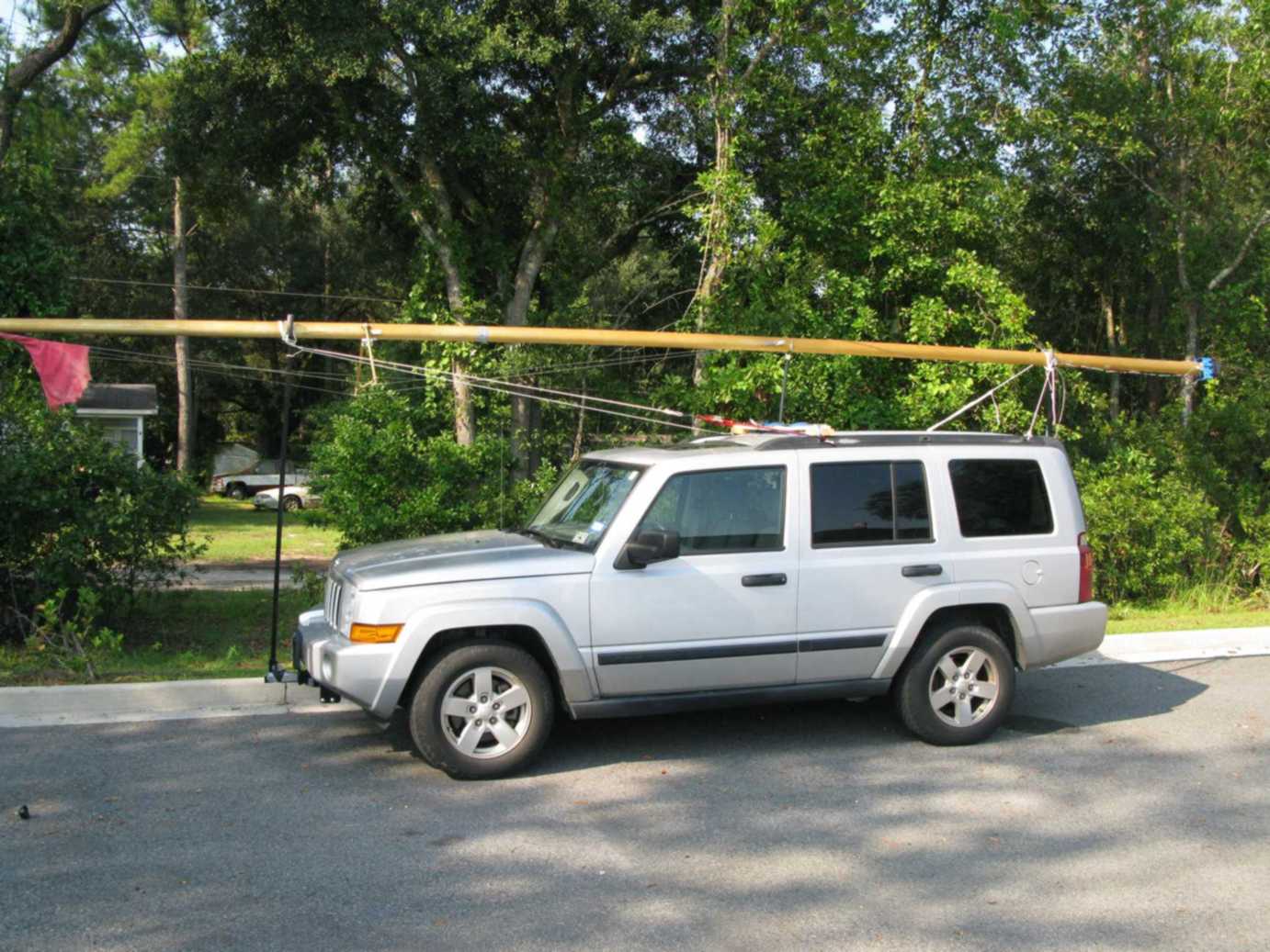

You could add a support from the trailer hitch to provide a third support point at the back of the vehicle. Two years ago I transported a 25.5 foot mast for a Rhodes 19 from Savannah, GA to central Texas (1200 miles). Due to the distance I was going to be hauling it, I added a front reciever hitch to my Jeep and made supports to fit in the rear hitch and front hitch. I also made a center support. Then lashed everything down well. I didn't impale anyone on the trip home. I also added a tail light to the end of the mast in back to make the mast more noticable.
Jeep and mast
Jeep and R19 Mast.jpg (176.98 KiB) Viewed 7758 times

jeadstx - thanks for posting that pic. I was wondering what my mast would look like on top of the Explorer - that gives me a very good idea.
I was most concerned about the potentiail to do damage (bend?) the mast at the mounting points, with so much at either end of the mast that would be unsupported. Although I would hope and expect the mast to be plenty strong to deal with any such forces, I wasn't positive.
I'll definitely have it lashed down well with a BIG flag on the end.
