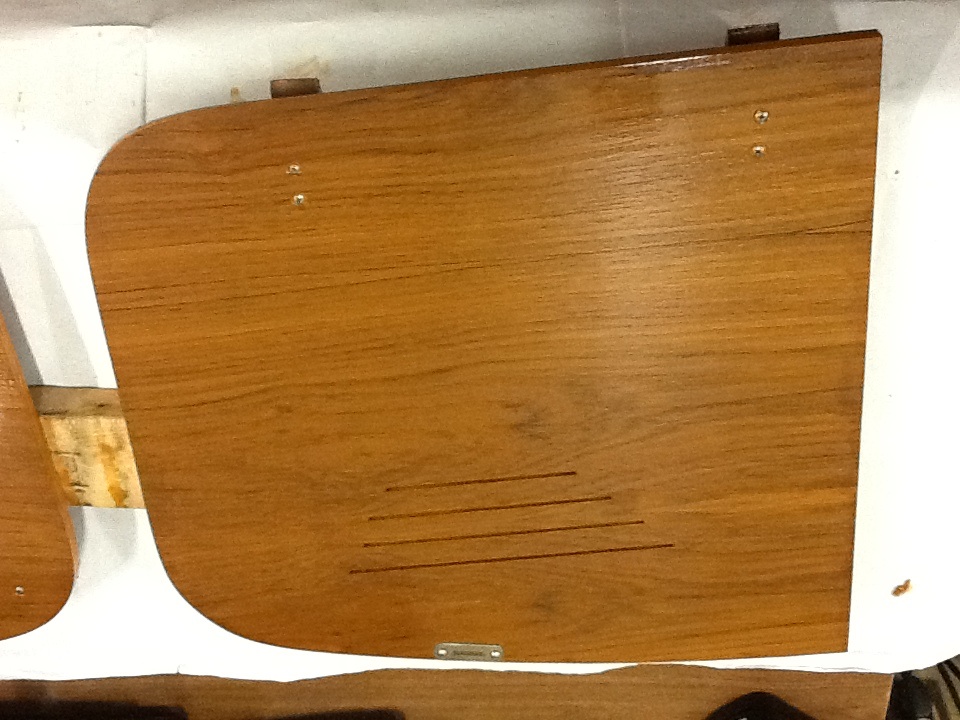

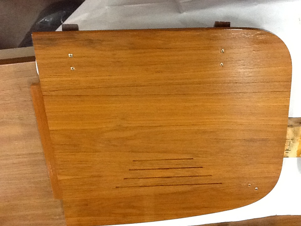

Postby Thomasjbrothersjr » Mon Apr 29, 2013 9:25 pm
These are my new cuddy doors with 2 coats of Cetol Natural Teak finish. They will take 2 more coats before I can say they are done.
New cuddy door!
New cuddy doors from Debby and Rudy at D&R Marine

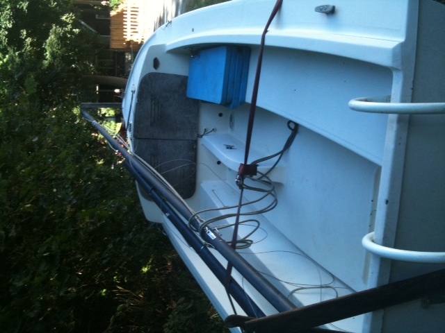

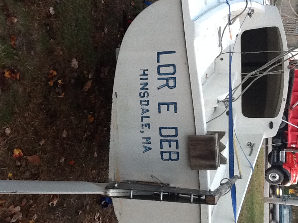

Postby Thomasjbrothersjr » Mon Apr 29, 2013 11:00 pm

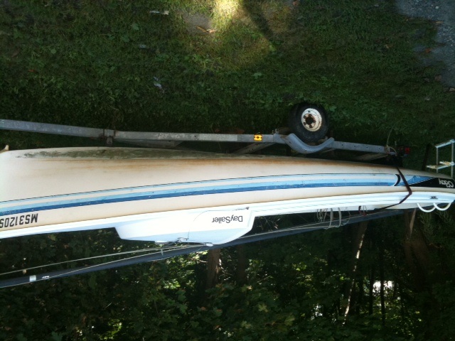

These are some before pictures...
As she sat in Pittsfield MA, where I bought her.
The Lorri Deb
First day... This is how she looked when I bought her.

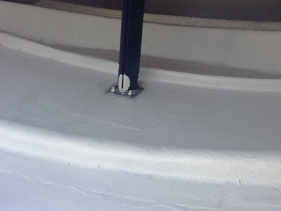

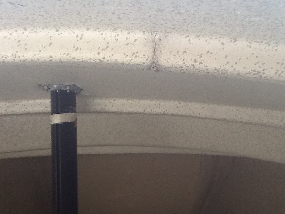

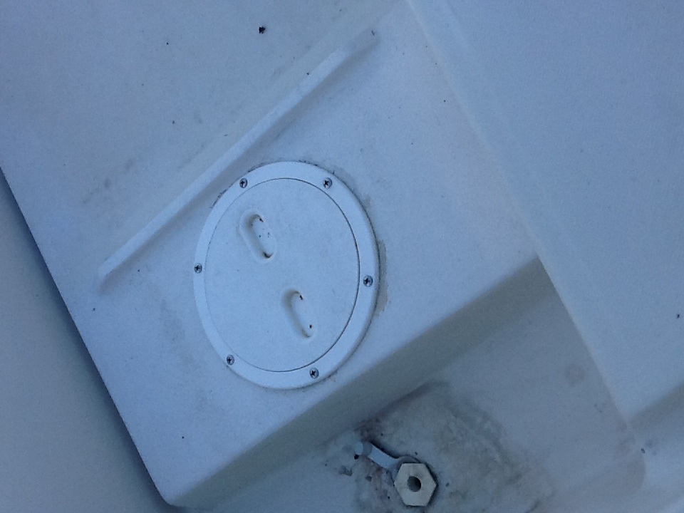

Damages than needed fixing.
Crack, all the way through to the bilge, in the cockpit, near the stern.
Cracks along the Cuddy stringers

Postby GreenLake » Tue Apr 30, 2013 11:26 pm
About the photos with the damage. We gave you some detailed suggestions for the crack in the cockpit bottom. If you need more, just ask some specific questions. There's also a crack near the top of the transom visible in your picture. Caused by a motor mount?
The crack in the cuddy front, if that's what it is, is in a really odd location, seeing that it's isolated to just the vertical surface. Does it show from the outside as well? If not, I would make that a candidate for "benign neglect". If it does go through, or if you can observe it "working" when sailing, you can always put a "patch" of glass on the inside.
The suggestion for that eventuality: 2-3 layers of mat or cloth wetted out with epoxy on a sheet of plastic, pressed into place after the surface was first rough sanded, and held in place with tape until it cures - if despite a good seal the plastic shows signs of sagging, support it with a sponge on a stick, or a similar contraption. After it cures, remove tape and plastic and after some more time to fully cure, cover it with any type of paint to a) make the repair blend in, b) keep it from failing after a few years due to residual UV reaching the cuddy (might be a decade, but even the cuddy gets some UV).

Postby Thomasjbrothersjr » Wed May 01, 2013 6:26 pm
I went with the inspection port advice that I got on here in one of the forums. The area was beefed up before it was cut in. The paint didn't match exactly, close. While he was in the bilge he replaced the drain as well, short money over at D&R.
There is also a picture here of the stringer repair. Super strong now, without any flex on he Cuddy deck. I asked how strong and my fiberglass guy hopped up there and walked around. He was a little over zealous with the paint though. The Kaleigh B gets its stripes later in the week and will go through a full stem to stern cleaning and waxing after.
Making headway...
Cuddy stringer and mast fix
8" inspection port... Where damaged area WAS
