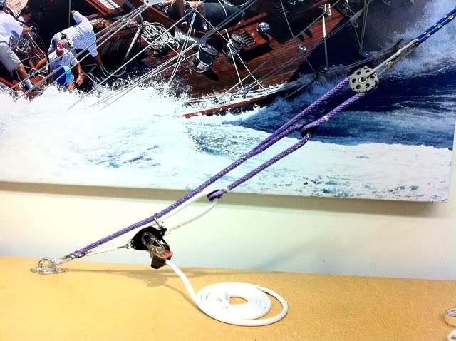

Mulling over the question of a boom vang.
Found an interesting design. (Follow the link to get picture and some discussion).
That system gives an 8:1 using just two blocks (and a few eyes).
Postby ctenidae » Mon Mar 21, 2011 11:53 am
Interesting. Very cool looking, at the very least. I got the West Marine 15:1 vang that was on sale last November for dirt cheap, but would totally be up for something like that if I hadn't.
