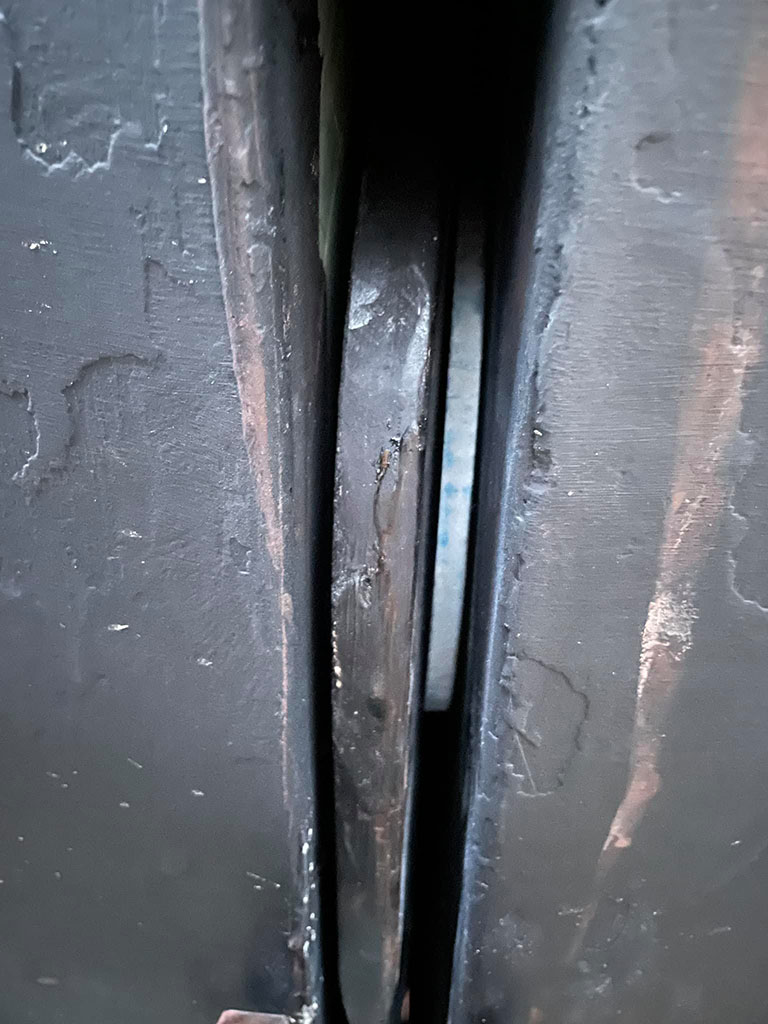

Postby Anstigmat » Sun Feb 07, 2021 10:44 pm
Re engaging in this old thread to see if anyone picked a specific method for their shims?
I am thinking of cutting some PVC sheeting into large washers, and using JB Weld to stick them around the square hole. I'm hoping this reduces the play/wobble in my board significantly. I do worry a bit about the wear that might be caused in the contact point between the PVC and the CB hump wall...
Anyway I'd love to hear some other solutions.

Postby Anstigmat » Mon Feb 22, 2021 10:09 am
Well this is likely to impress just about nobody, but I think it just may work!
My handle pin extended into the trunk with the 'square part' going into the CB. If you will recall the remainder of the handle has a curved dome end to it. This was not extending all the way to the other size of my trunk for whatever reason and the board was wobbling a lot. My concern was that it would slide from off the square part on to the dome a bit, or back and forth and further wear out the square hole. Also creating a lot of knocking around.
I think the HDPE is a better choice in general, but I already had PCV sheeting, so that's what I used. I simply eyeballed a 'washer' shape over the square hole, and cut it out of the sheet. I then drilled a hole so the dome part can stick through the washer. I attached the washer to the CB with a screws. I also rounded the edges a bit with a sander.
So now the board fits much better with no risk of it moving back and forth. It still has some capacity to wobble I think, but I hopefully just won't lose the ability to raise and lower it as needed.
If I could lift the boat high enough to full lower the CB down, I could trouble shoot this more. However I used ratchet straps and a jack to get it off the trailer enough to the point where I could pull the trailer out from under it. The challenge I had was that of course ratchet straps don't let you slowly loosen the boat down, they just let go. I could only raise it high enough to the point where I could get the trailer out, and back in, with enough space for my smallish jack to take over and slowly let it go down on to the trailer.
The folks at O'Day were quite clever with this CB design but I do wonder if a simpler design isn't better. It would be nice if I could just insert the board like I remember doing on Sunfish sailers. I don't have a bunch of buddies to come help with this so everything is a lot harder to accomplish by myself.
Anyway, job's done. Now I get to cut holes in my seats for re-foaming.

Postby GreenLake » Tue Feb 23, 2021 7:07 pm
Looks good. Let us know how it's working out.
