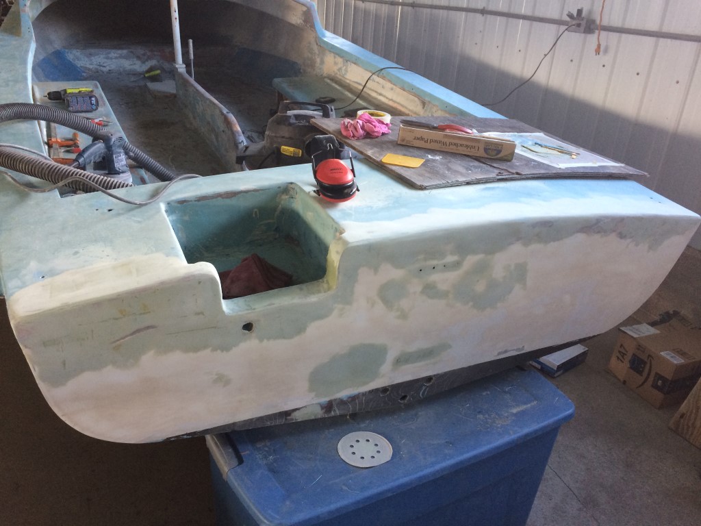

Finished sanding the fairing on the transom today, just need to touch up a few spots:
transomdone (Medium).JPG (165.41 KiB) Viewed 499070 times

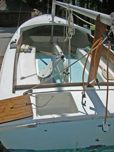

Was again sanding my wooden footboards today, and found more rot in one of them. It's salvagable with sculptwood, but I have a really hard time justifying throwing at least $100 worth of preservatives into wood that's already well into deteriorating. It's just 1/4" plywood anyways, easy to replace, but...
If I need to buy wood anyways - and having seen the above picture of another Sailstar 17 with wooden furniture - I wonder why the heck not just replace the coamings too while I'm at it? I did some Microsoft Windows shopping at Home Depot and this was the best I could come up with:
https://www.homedepot.com/p/Columbia-Fo ... /204636957
Sure, it's plywood, but it's got a mahogany veneer (way better than the pine my coamings seem to be made of,) and the plywood aspect might actually make it easier to bend to form. Plus, I don't need a solid super strong piece of hardwood if I'm going to clearcoat + WPU the whole thing anyways. And there's enough wood in one 3/4" x 2' x 8' sheet to get both side coamings and the rear coaming out of it. And so that I wouldn't be sitting on a 3/4" edge of plywood, I would probably cut the tops of the coamings flush with the deck. On my boat, the coamings don't seem to be really reinforcing the side decks, as underneath them, and behind the coamings, there are a bunch of perpendicular triangles glassed in to support the deck.
Thoughts on this budget idea?

If you want to use plywood (veneer or not) make sure that it is fully sealed in epoxy and the that top edges have a strip of glass cloth over them because it's a heavy-use area. That's the only way you'll have that plywood last. Otherwise, it will get water in it and delaminate eventually.
You also need to meticulously seal any and all holes, but if you do, it should last many, many years.
Note that a glass strip, if fully embedded in epoxy will become transparent and invisible. So it won't detract from the wood. Just need to make sure you add enough epoxy until there's no 'print through' of the weave. Even if that means touching up by adding a bit of epoxy after the first layer has begun to cure.
The coamings need to be strong enough that you can't knock a piece out of them by sitting on, climbing over, etc. so, something closer to 1/2" would be better than 1/4" for plywood (and a bit of glass to protect the surface). The other load they carry is to hold up the side decks. That part is easy because that dimension is a few inches and even 1/4" would be strong enough.
PS: I would concur that trying to use SculpWood for repairing large areas of any piece of wood that can easily be removed/replaced is probably not ideal. It's intended for cases where you have a focused issue in a piece that's hard to remove, or otherwise difficult to replace (for example, if it's a piece milled/cut in a complicated state).
