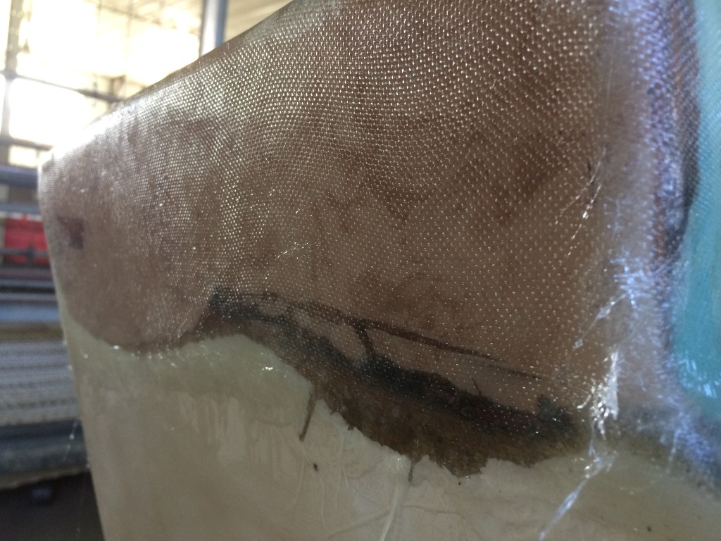

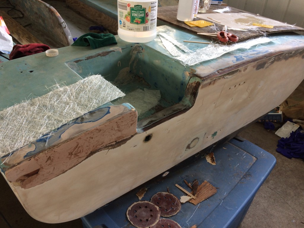

So I'm most of the way through the transom repair. Upon using the GelMagic I realized it got squeezed out a lot, so on the "messy side" I just completely ripped the flap of gel coat off along with the remaining layer of plywood that had started ripping off, since it would have been too complicated to go behind the gelcoat and use filler for the half that was missing the layer of plywood and then GelMagic the remaining plywood layer to plywood and then GelCoat to plywood, esp with how much GelMagic goops out once clamped.
So once I ripped all that junk off on left side I just spread Rotfix on the clear spread of remaining plywood, and Sculpwooded over that. Looked like a kid's messy playdough job, but once sanded it looked great.
Side to the right of the engine well was more straightforward, and I GelMagic'ed that twice (after first time I saw the thinner portion of it still had a gap so I spread that part open again and spread the Gelmagic better with a popsicle stick.) After that it held very nicely.
For fiberglass, I decided to use the same layering for all the repair spots, folding one layer of CSM and one layer of cloth over the edge of both left, right, and on the ledge of the motor well. This *mostly* worked well, except for a few places where there were air pockets I couldn't get rid of, and some complications that came up because the glass+epoxy didn't want to fold and stay where I put it. I wasn't using transfer sheets or anything, I dunno if that would've helped. Have never used them yet. I also went ahead and covered that big patch of Sculptwood with the same CSM + cloth layer. Came out really well. Today I started building up the top edge of the transom with the 3M High Strength Marine Filler and just need to do one more sanding to get that locked in. I like that it just takes 30 minutes to cure; really fits doing a bunch of work and coming back to it in a reasonable amount of time rather than waiting hours like with epoxy.
Transom as I get ready to glass it
Left side Sculptwood after covered with glass
