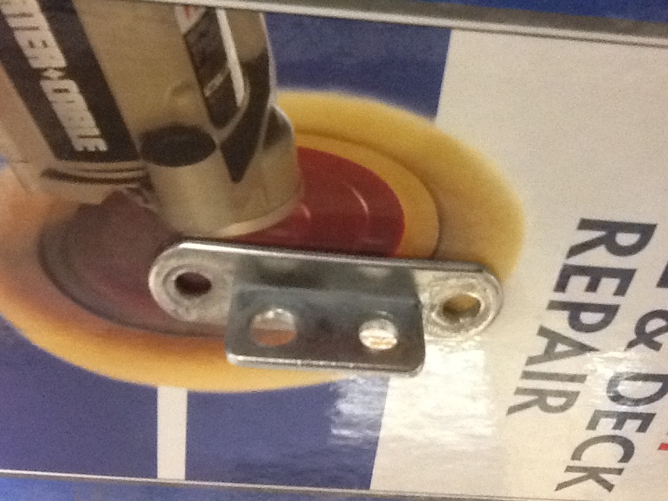

This is the 2 holed stemhead that I replaced. It seemed original 1983 Oday, based on no other holes beneath it. The 3 hole one in previous pictures came from Rudy's shop, so I assume it is an Oday part. I do not know which boat it was meant for but will ask him when I talk to him again.

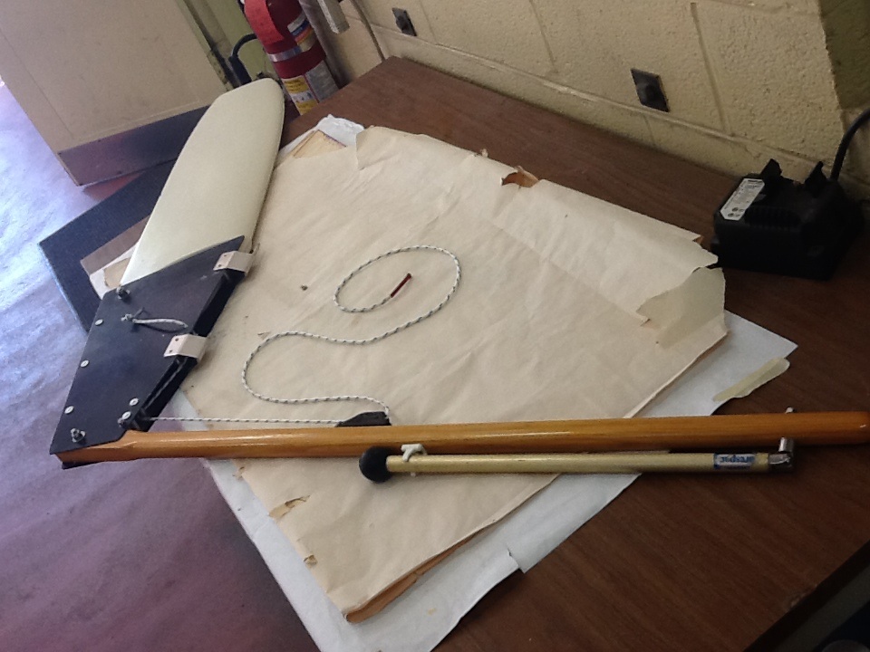

Postby Thomasjbrothersjr » Sat May 04, 2013 5:40 pm

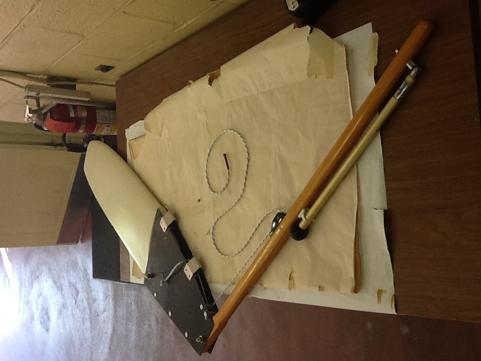

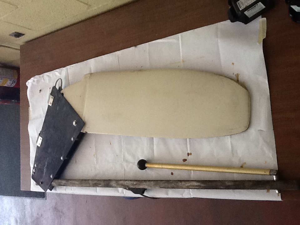

Rudder and tiller as I bought it... Years and years of neglect. I brought it down to D&R to look at and said that although it was original, Oday had a bunch of these setups left over from the 15 (which didn't do so well) and decided to fit the daysailer up with them from 1983 on. It wasn't really intended as a DS rudder/tiller.
Rudder and tiller before restoration

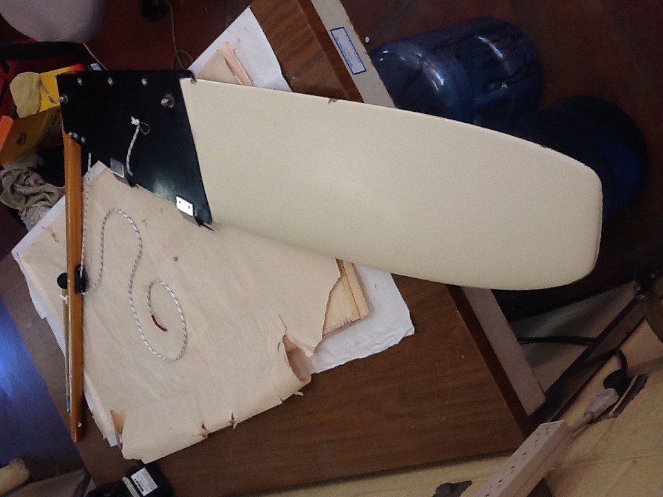

I coated the solid ash tiller 4 times with Cetol. I next mounted the tiller extension clamp and jam cleat for the line that hold the rudder down. I drilled pilot holes and used brass screws. A new line was whipped and installed through the top hole in the blade and then re routed to the tiller and cleat. The rudder blade was washed, wet sanded and waxed. There are two good sized dings that I am going to fill and sand out this week. I put it all back together and must say it looks 100% better.
Rudder and tiller after rehab

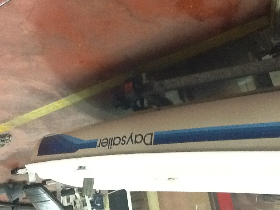

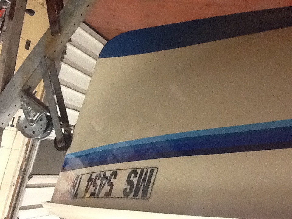

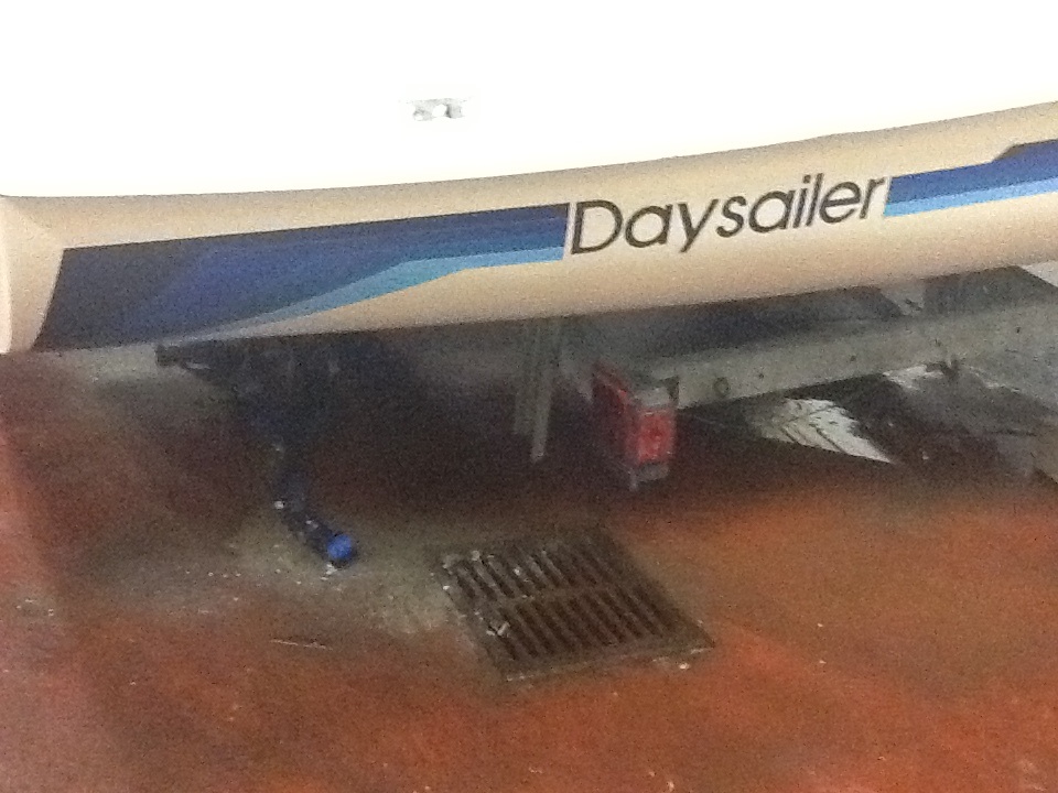

The KALEIGH B got her "some what original" look back today. The colors are the same but the tail piece and the lettering are from a DS 3. Theses decals have some age to them which made me curious as to how they would behave. There was still a shadow from the previous striping so we had an excellent line to go by. I used the wet application method. This requires a solution to be sprayed on the hull as well as the decal. It allowed us to move, place and then sometime replace the decal until it is in the proper position. We used a squeegee to get all the bubbles and air out from behind the decals. Once the decals had set up and all the bubbles are out the clear plastic protective covering had to be removed. These decals are original O'Day stock and Are old. The protective coating came off, but not without some extra work. It left behind a ton of adhesive. A few hours of elbow grease and a citric based cleaner removed the gummy tacky leftover. Satisfied with the way things went I warmed up he decals with a heat gun, removing any remaining bubbles and giving the adhesive permanency.
Port side
Port stern
Port bow

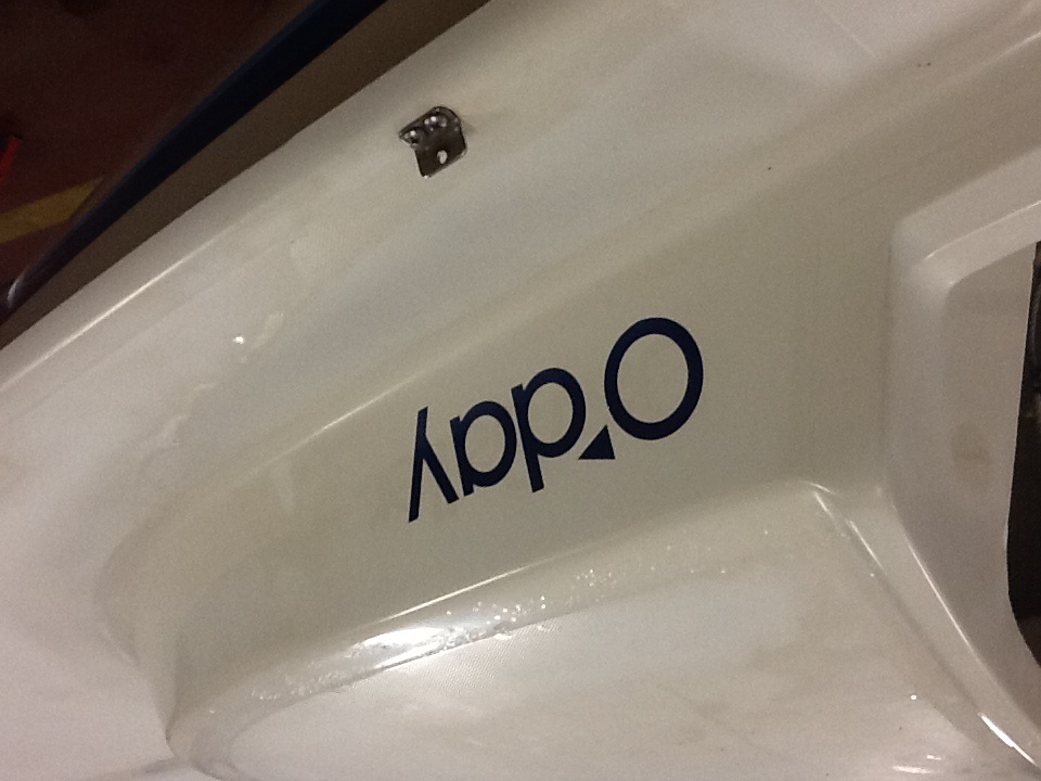

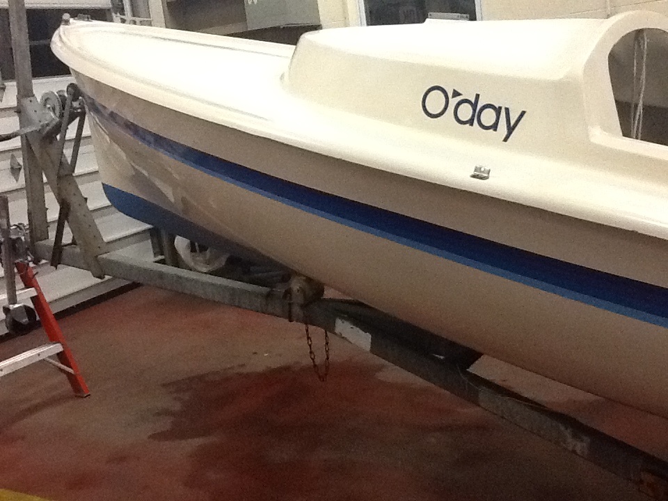

Postby Thomasjbrothersjr » Tue May 21, 2013 1:18 am
More pictures of the KALEIGH B and her new look. She's all dressed up now!
Cuddy lettering
Starboard tail
Starboard bow
