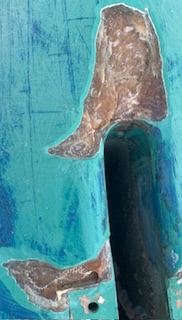

Crack front of centerboard, nearly through hull
Postby BaltimoreChess » Sat May 17, 2025 10:00 am
I’m fixing some cracks around the front of the center board, on the hall. I read through a bunch of the other forum notes. My plan is to use fiberglass mesh, and vinyl resin to build up and fill in the gaps where I ground down. If you zoom in on the spot towards the front, you can that it looks like I am almost through the resin entirely. You folks think I should go all the way down to the mesh, or should I stop where I am at and do the glass and resin work? I’m open to any suggestions about how to build up around the plate screws as well.

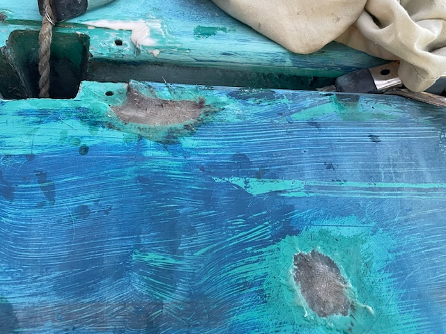

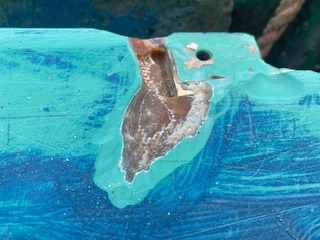

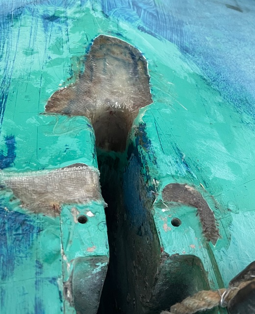

Postby BaltimoreChess » Wed May 21, 2025 4:22 pm
Providing an update! I kept grinding away at the cracks near centerboard trunk on bottom of hull. I found that most of them went all the way through hull. To resolve I used glass cloth with west system 105 epoxy/502 hardener.
For front of centerboard trunk area - small spider cracks were ground out this included going down into slot. I put multiple layers glass/epoxy for strength. (2 sessions of glassing, each session had 3 layers glass)
For side areas around CB slot - couple of spots near the CB plate had cracks which made me nervous, so I ground out and glassed instead of just epoxy.
Next step is to fill and fair. I’m still working on improving my skill in optimal mix epoxy/fill/hardener to be able to shape these non-flat areas. I’m probably overkill I’d assume, but would love to hear others thoughts.
I’ll give more updates as I go.
Daysailer II - centerboard front edge repair.jpg (145.51 KiB) Viewed 1065 times
Daysailer II - centerboard trunk front.jpg (159.42 KiB) Viewed 1065 times

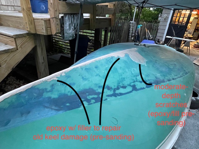

Memorial Day Update!

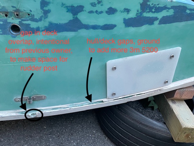

Spent the weekend doing the below:
- some epoxy/fill work on the keel - still needs sanding
- epoxy/fill work to cover fiberglass crack repairs made at front end of centerboard trunk
- grinding out loose hull/deck sealer - there were holes/loose spots intermittently. used angle grinder and skinny cutting blades and fatter wheels (there were some "oops" along the way which I'll fix ;)
- transom work included deck/hull seam and grinding off screw heads that were either rusted in place or were spinning in their holes. The ones loose in holes were below water-line - not great.
Pics included:
- deck/hull seam work
- epoxy and hull work/sanding overall (west system 105 epoxy/205 hardener, orbital sander 50 grit)
- transom with same deck/seam issues (ground out, using 3m 5200 to seal), and gap deck/hull lip for rudder post made by prev owners
Oday Daysailer II - Keel Repair.jpg (105.92 KiB) Viewed 987 times

This is a DSII. Therefore the transom should be a sandwich with plywood across the whole width. If I remember correctly what other DSII owners have posted here or elsewhere. The radical repair was to cut off the whole transom and rebuild. A localized "hardening" will most likely leave you with a hidden section of weak damaged plywood in the bottom half of your transom.
But I understand the appeal of avoidiing the most radical repair.
The quick and minimal fix would be to try to dig out a limited section. Just enough to support the screws for the lower gudgeons. You could use a bent nail in a drill to clear out some of the wood and replace it with a mix of epoxy and short strands of fiberglass, cut off from the edge of some cloth.
That would form into a plug that you can then drill for the screws. Or wax the screws and insert with epoxy still soft.
You can look into products like System Three RotFix to treat the surrounding wood before doing those plugs.
A slightly more thorough repair would be to slice off a strip of the existing transom between the drains. That would expose a larger area of damaged wood and allow you access to scrape out more of it beyond the opening. With some luck, you would reach a good fraction of damaged wood that way. That level repair is better at strengthening the transom to take the loads from the rudder, over just holding the individual screws. Even having a dozen square inches at full strength would be like having a big backing plate rather than relying on the strength of the outer skin of the transom.
A boat or wave that hits your boat from the side will put enough force on your rudder that it can break in the worst case. Happened to me. You don't want the transom to be the weak spot in that scenario. Taking on water is the obvious risk. So the task is to do more than just seat the screws.
Again, treat any wood you can't reach with the RotFix system. Then replace the wood you took out with some fresh plywood. Probably in sections and embedded in thickened epoxy. Overdrill the screw holes but don't fill yet. And then laminate to close the outer skin. For best result and strength the edges of the old laminate should be beveled. Finally, drill the screw holes. Fill with thickened epoxy through the holes and before it cures insert waxed screws.
You will be casting threads in place. Better than drilling.
Hope this gives you enough to plan your preferred approach.

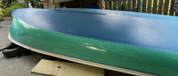

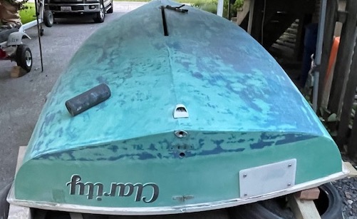

Postby BaltimoreChess » Mon Jun 09, 2025 8:46 am
Sharing updated pics of the hull now that sanding/painting complete on the topside. During the process I used a 3M "eraser" wheel to remove all the old/damaged pinstripe and "Oday" label, then light sand and used the Ezy Poxy Topside paint Sea Foam to match previous paint. I also added 3M 5200 sealant at deck/hull seam where there were some gaps as well. The gaps were especially bad at middle/top of transom. It appeared someone had either intentionally ground out a piece of the transom edge to make it easier install/remove rudder - either that or years of rudder post smashing transom on way up did the damage. I sealed this gap internally with a ton of 3m5200 and will try to gelcoat or glass on top of this to protect. (**that's my approach anyway - open to suggestions!)
Pending/next steps:
- Replace the centerboard uphaul/downhaul assembly (wire, rope, shockcord in cuddy - pulling board down/up) - wire seems to be in decent condition but might as well update since we're doing work.
- Insert pipe/PVC in hole from cabin/centerboard trunk that wire goes through - lots of folks on forum have indicated this is a common water-entry point. Question: Are folks using PVC glue or something to hold this pipe in place? I'll revisit forums for details tho...
- Flip boat back over onto upgraded trailer with 5-6 buddies...
- Do some light gelcoat repair on transom - previous outboards being used must have moved around and damaged down to the glass. Question: Do any folks put some kind of protective material on top edge of transom under outboard? I could see this being helpful in minimizing transom damage. Maybe thin marine plywood or white acrylic..
Thursday night/Friday morn - if we're lucky:
- Set up all the rigging and check for what else we missed!
