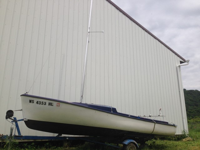

Rudy from D&R was very helpful and hooked me up with new stays, rubber spreader boots, and a windex. Just got the stays on today and they fit right. So excited.
finally!
IMG-6165 (Small).JPG (63.79 KiB) Viewed 26838 times
You know the boats been waiting too long when just mowing the grass around it feels like a big step!

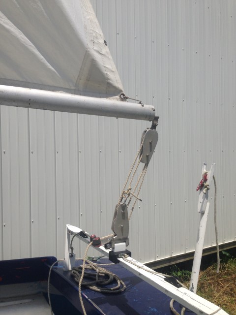

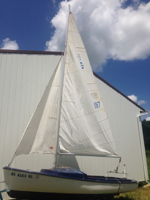

Sooooo close. Wife and I raised the main and jib today (or at least the best we could having never done so before.) Turns out the outhaul line was already attached to the main and there was a cleat and a loop to wind it through so that was self-explanatory. Not sure I got the sail tensioning right, but I can show that to my local guy and see what he says. Also grabbed a random piece of rope in the bag and hooked up the traveler. As you can see, the guy who sold the boat to the guy who sold it to me made a custom piece of equipment to moderate traveler...travel. heh. At least, I think that's what it's for.
My only concern now is that the lower batten in the jib is snapped in half, and the battens appear to be completely enclosed in the sail. Is it normal to have to remove stitches to remove a batten? Is that something a layman can do? Is it dangerous to the jib to try to sail with the bad batten?
Oh, also, my wife especially whether the jib sheets go straight from the clew to the blocks on either side of the boat and then to the cam action cleats next to those blocks, or whether those sheets go through the two blocks on either side of the base of the mast.
jib and main up
IMG-6179 (Small).JPG (70.42 KiB) Viewed 26788 times

traveler traveler
IMG-6181 (Small).JPG (69.31 KiB) Viewed 26788 times

The whole point of a traveler is that you can adjust its position laterally, changing the direction the mainsheet pulls on the boom. Having the traveler this far back reduces the angle over which it is effective, but it should allow you to fine tune things for upwind work up to a close reach, I'd think.
The jib sheets do not pass the base of the mast. They normally go to track mounted fairleads or blocks at the forward end of the cockpit. They are on tracks so that you can adjust the angle of pull until the sail "breaks evenly over the entire length of the luff". Translated that means, when you come into the wind, both top and bottom of your sail should stall (begin to flutter at the luff) at the same time. If not, move track forward or back to adjust.

Battens for the jib are not typical for DaySailers, but you can fix them easily yourself.
Just undo the stitches at the end of the batten pocket, pull out the broken one, and replace with something of similar stiffness and dimensions.
I once made a set of replacement battens for an old main from paint stirrers. (To get the correct width, I ended up ripping two of them to 2/3 of their width and gluing them edge on; felt a bit dubious but worked fine). Make sure you varnish or paint them to give a bit of protection when (not if) your sails will get wet.
Insert and re-stitch with polyester thread (the clear stuff) or fishing line, or some strands from an old polyester rope. Whatever you have at hand. Don't stress about having a sailmaker's needle, palm and all the other stuff.
You could try sailing without, but I suspect some PO found them necessary to keep the leech of your jib controlled. Replacing the broken one is quick, so probably the best to keep it that way. Don't be surprised if replacement sails don't have them.

-You can either go with a mid-boom mainsheet, or and end-boom system. For mid-boom, yes, you'll need a fiddle-block. For end-boom, you'll need a rope traveler (also called bridle) and your mainsheet will most probably still go to the centerboard, but only to a single block. Note, yes, you can have a pure end-boom setup, with the sheet coming off the transom deck to your hand, but that's "just silly."
Anyway, if your rope traveler/bridle is getting tangles in your tiller, I think you have it too low. Here's a good guide for all things DS rigging:
https://www.daysailer.org/Rigging-Guide
And yes, technically a rope traveler (moving parts) is not the same as a bridle. Sill think your bridle is too low, it should be about 22 inches from deck to your lower block.

Your stern bridle, when going upwind, should be under tension and well clear of the tiller. Mine ends in a block and therefore I have two parts of the mainsheet connecting the boom to the block on the bridle.
