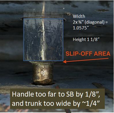

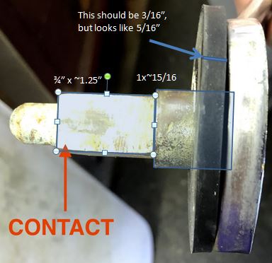

In diagnosing your situation further, it would be interesting to find out whether the real issue is that the CB trunk is too wide, or that the CB handle is too short, or perhaps mounted too far to SB. (Perhaps because of too thick a gasket?).
To that end, I've added some dimensions to your picture.
"contact" with dimensions
I know from my attempts at squaring the hole that the square section is 3/4" at its widest (it's slightly tapered). If I take that as known, I can "measure" the other dimensions in your picture. I have a spare gasket sitting around and that came in at 3/16". From your photo it looks like yours is 5/16". (I may be off a bit, so it's worth confirming). From the "pivot" photo, it looks like at least 1/8" of the square section is buried in the SB CB trunk wall. You could go to a thinner gasket and that would alleviate part of the problem.
"pivot" with dimensions
That picture confirms the 1/8" discrepancy. (You may want to double check these measurements using the real object).
However, it seems that the CB trunk is also too wide at that location. Adding just 1/8 does not allow the outer rounded section to fully insert on the other side.
However, what we've seen from the tolerances on some of these boats, having the dimension off by even 3/16" or 1/4" wouldn't really be that surprising. In use, the walls also flex noticeably. That's the reason for the retrofit like it was done on my boat.

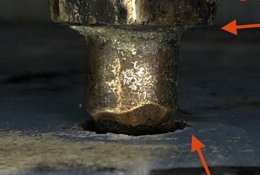

Postby GreenLake » Tue Jul 21, 2020 11:54 am
Jim, you tell me.
Detail
In this picture, it does look like there's a drilled hole. In another picture, you can see that the bottom face (in this orientation) of the pin shows signs of manufacturing instead of being rubbed blank. Unless @LGSailer tells us otherwise from direct observation on site, I'm prepared to believe that his CB trunk has the required recess.
If it is a case of the trunk being too wide, then bolting the pin from the reverse will also reduce the amount of "free play" available to the CB inside the trunk. It might be further reduced by either shimming the top sides of the board and/or by narrowing the opening of the trunk by adding some strips of material. Or both. And adding a strip of several layers of fiberglass on the outside of the trunk wall should help with flexing.
