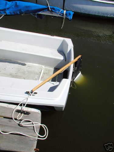

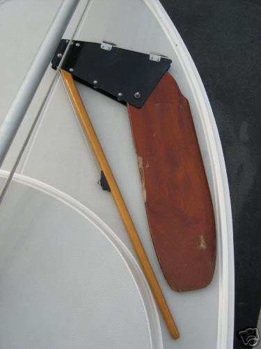

Lines to raise the Rudder were never standard on the Day Sailers from O'DAY. The late 1983-85 DS II and all DS III did have a line to hold the rudder blade down. The rigging of that down line was similar to the rudder on the O'DAY 19, 192, and 222. The picture below isn't best, but from what I can tell looking at a 222 rudder and this one, the down line attaches to the leading edge of the rudder blade in the notch where the rounded top meets the blade, it then leads up inside the pintles (I think there are metal spacers between the side plates that the line runs over?) to the underside of the underside of the tiller where there was a clamcleat.

i rigged uphaul and downhaul lines on my ds rudder much like in the pics. however I use a clam cleat so it will give in case of grounding. The pics show a horn cleat
