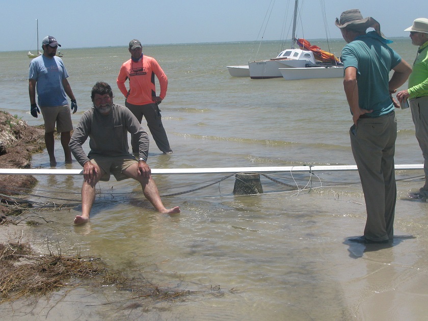

On the Texas 200 this year we had a boat (Cortez 16) arrive at the third camp with a noticeably bent mast. They removed the mast and took it ashore to evaluate and try to straighten it. The skipper of the boat got the mast mostly straightened by sitting on it while it was supported. My crew took the pictures so I don't know the exact procedure used, not sure if he carefully sat on it or there was gentle "bouncing" involved. Attached are a couple pictures, one showing the bend, the other showing the straightening. The boat sailed for another 3 days (about 110 miles) after this.
Bent Mast
Bent Mast.jpg (250.6 KiB) Viewed 10366 times
Repairing mast on beach
Bent Mast Repair.jpg (215.93 KiB) Viewed 10366 times
