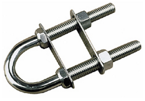

I urge installation of a stainless U-bolt rather than a single-shaft eye-bolt. Every single-shaft bolt I've ever seen on a DS has been loose. Within a few years, O'Day had stopped using single-shaft bow eyes. This is what came as original equipment on a 1979 DSII I used to own. It's from Sea Dog, 3/8" stock. $13.99 from West Marine, maybe cheaper elsewhere:

Postby KingsTransom » Tue Aug 02, 2016 10:18 pm
The 3/8"-16 stainless single eyebolt has a huge yield strength, especially compared with the fiberglass hull, which is the weak link. I don't think drilling two holes in the weak link makes for a stronger attachment. Based on what I've read here, I think the problem with the Daysailer's bow eye was the use of non-stainless hardware, wood backers, and nothing to keep the eyebolt from turning. I think the only thing a U-bolt adds is an easy way to keep the bow eye from turning.

Postby talbot » Wed Aug 03, 2016 12:07 am
My thought is that the turning is what enlarges the hole, leading to more movement and more damage. In any case, the u-bolts I have seen have been in better shape, for whatever reason.

On my DS, the fiberglass appears anything but a weak link. Particularly at the bow, the sharp angle stiffens it, and the laminate thickness is probably one of the highest anywhere on the hull. If you find a single-bolt eye loose in the hole, then the cause may indeed be a piece of wood backing suffering from dry rot. I don't recall such a thing from when I did my repair, but it's a long time ago by now.
Anyway, a better backing plate would be the answer.
The little plate shown for the U-bolt isn't substantial enough to really help prevent the fitting from tearing through the laminate. (Practical Sailor just had a review of backing plate dimensions and materials that's highly instructive - subscribe and get access to their online database of test reports).
I also don't think that having a double bolt helps in case of stress corrosion. Once one of the bolts breaks, the fitting is liable to pull open under moderate loads.
However, I fully sympathize with anyone who just prefers that design. Whether it is because it cannot rotate, or for any other reason.
