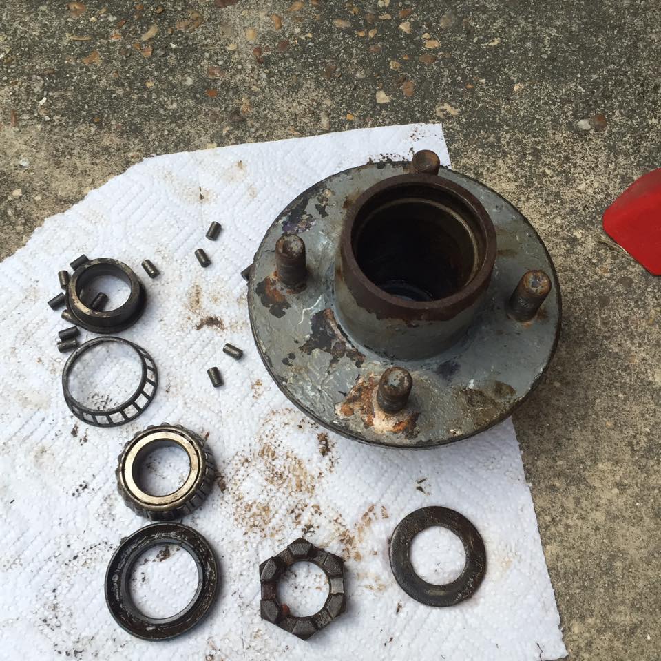

So, on my quest to make sure my trailer is efficient and safe, I decided to check out the spindle and bearing on my trailer's axle. Come to find out when I popped the bearing buddies off, the inside was full of mud looking grease and water, accompanied by fairly nice size shards of metal. Furthermore, it appears the spindles are pitted, presumable from the water that has been sitting in there. And finally, the back bearing would not come off until I sanded down the spindles to remove some of the pitting. The back bearing was where the larger shards of metal were resting as well. I accidentally dropped the back bearing (a few feet), and all the little rollers fell out. A few pictures are below...

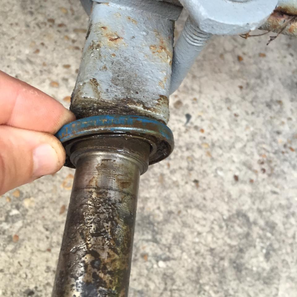

2. The seal to the back bearing, that is presumably supposed to seal to the spindle to keep water out, seemed like it was able to rock around a lot (see pics), but the rubber ring around it was in tack. Is this normal? Is this a location to be concerned about water entering? Was the hub possibly mis-sized to the axle?

If you'll worry about the axle, replace it. The U-bolt that holds the spring, also holds the axle. While pictures are good, nothing beats looking right at the job, so the final say is yours. That said, the pitting looks to be on the shaft between the bearings, not where the inner races of each bearing contact. Large-radius pitting will only weaken the axle by the reduction in area, whereas sharp notches weaken by creating a stress-intensifier, from which cracks may propagate. Use a sharpening stone and oil on the axle, not sandpaper. Being hard & flat, a stone will do a good job of grinding off the high spots without removing much that you want to keep. Sandpaper is just random, though better if backed by a block of steel.
Ordinarily, if the races look perfectly sound as do the rollers, you can reuse the bearings, but without removing rollers from the cage, it's hard to see all surfaces of all rollers and impossible to inspect the inner race. If you're picking out pieces of metal, replace the bearings. The chips are either bits of the roller cage that have corroded and self-destructed, or flakes of the race and/or rollers that left due to Brinelling. The metal bits may also be what's left of the seal's spring, used to press the lip against the axle.
Seals can fail in a number of ways, mostly by the wear and tear of the lip(s) that contact the axle, or by the seal separating from the steel carrier. Corrosion of the axle where the seal lip makes contact can quickly eat up a seal and are a good reason to replace the axle. The tech at the trailer service center near me said he never uses bearing buddies because they cause seal failure. While mine was only one case, the seal did fail with BB's. It would be unlikely to have bearings that would fit a misfit hub to the axle.

The part in the hub that the bearing sits on is the outer race - part of the bearing. These must be replaced when replacing the bearings as the bearings are a matched set of inner & outer race, plus rollers. Nothing is interchangeable. The axle spindles are stubs that fit into the axle beam (U-channel) that makes up the axle assembly. I do not understand what the spring center to spring center would have to do with it. No welding should be required to swap axle spindles.
The bearing buddies do not provide an adequate means of packing the bearings. If that's all you did, you must remove them and pack by hand. The grease is not just for lubrication, but also to move heat from the bearing to the hub. Air pockets prevent that movement of heat. Put a tablespoon of grease in your palm and, with the bearing in the other hand, scrape off the leading edge of grease with the bearing cage until grease comes out the top. Walk the bearing around until grease has come out the top of the full perimeter of the bearing.

The whole hub assemblies were replaced. They came with a new hub, lugs, bearings (front and back), races (front and back), seals, cotter pins, and caps. The axle w/ spindles, and castle nuts were re-used. Bearing were packed prior to install, and lubed the crap out of everything else by hand. Once installed, I used the grease gun to finish filling them up. What a messy job...
