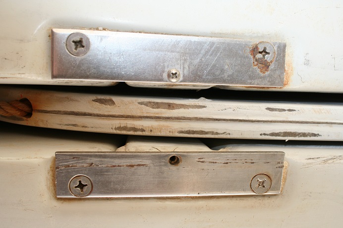

Postby jeadstx » Fri May 20, 2016 1:47 am
tinafred sent me this picture of his wedges.
DS III - centerboard wedge plate.jpg (118.89 KiB) Viewed 11446 times
Re: Centerboard repair needed?
Postby tinafred » Fri May 20, 2016 2:29 am
Do I need to take my centerboard off and redo the edge showing in the image?

Postby Skippa » Sat May 21, 2016 8:24 pm
Mine looked just like that, I was working with epoxy on the bottom so I just painted a layer on the leading edge. Will take a look at it in the fall to see how well it holds up.
Postby Alan » Sat May 21, 2016 11:13 pm
Looks just like my centerboard.
Once the board is pivoted downward into sailing position, the part of the board in the photo will be up out of the water. How does the board's leading edge look (the part that's farther aft when the board is up, that will be in the water when the board is pivoted down)?
Postby tinafred » Sun May 22, 2016 10:26 am
I am very, very new to the DS3 both sailing it and any repairs. That said, when I took those SS plates off, this is clearly a closed system. The only path for water to enter the bilge or anywhere else is where the 1/4-20 machine screws enter the hull. What I did was placed the BoatLife Calk tip in the hole, checking the inside bilge compartment ensuring a healthy amount of chalk is placed inside. With the screws inserted, I gently smoothed a cone around said screw with my hands thru the inspection port. The smaller screw in the plate never enters the bilge, just screws into the wedge which stays within the centerboard housing. Once the machine screw entry point is sealed with chalk there is no need for more chalk. Now I did back out the screws after the dried for hours to make sure I did not make them permanent inserted screws, then tightened them up. I took my boat out later that week and had no water in the bilge, dry. Prior to this PM the threads were clearly visable inside the bilge thru my inspection port with no goop with gallons of water leaking when I filled the bilge. Initially it was not clear where the water was coming from. There was a ton of old chalk all around the wedge, up into the centerboard housing but not limiting the CB travel. I scraped all this off, cleaned with acetone, and replaced with a lite coat immediately around all three screw sites, more on the 1/4 screw areas.
