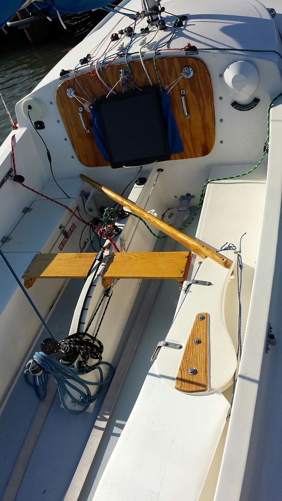

Postby talbot » Tue Apr 28, 2015 5:36 pm
Talk on the forum about the Texas 200 reminded me to post my response to the broken rudder head reported a couple of years ago during the event. The attached photo shows a standard rudder head with two oak straps bolted and epoxed to the wings that hold the rudder. The two upper bolts go all the way through the solid glass above the wings; the lower bolt is the rudder pivot. I heat-bent the oak to conform to the curve of the rudder head before attaching. The wood is finished with West System epoxy, varnished on top to reduce UV deterioration.

Here are pictures of the rudder head damage that happened on the 2011 Texas 200. The damage was caused when the blade was stuck in spoil mud while trying to push off from shore. With the original rudder head, the blade does not rise high enough for the shallows of the Texas coast when beaching. My solution in 2012 was to make a new rudder head that would allow the blade to rise most of the way out of the water by means of an up haul.
2045
To allow us to continue sailing the event, a hole was drilled below the crack to attach the tiller. The tiller sat at a 30 degree angle for the next 4 days of sailing and the rudder was removed for beaching.
2046

Postby GreenLake » Wed Apr 29, 2015 3:51 pm
Interesting, why do you think it cracked above the top gudgeon?
Normally, I would expect damage like that, perhaps, if the tiller got stuck on something in the cockpit while the rudder was wrenched about.
If it was a simple side load on the rudder, you would expect a crack in the area where Talbot added the reinforcements.
Re: Rudder head reinforcement
Postby jeadstx » Wed Apr 29, 2015 5:02 pm
With the force of the blade in the mud, the rudder head was trying to lay back flat across the transom which would probably cause the failure that you suggest. The tiller was attached and as I recall it jammed prior to the head being able to lay flat on the transom, which is the cause of the damage as you would expect. I kind of remember watching it in slow motion (or what now seems like slow motion, actually it was quick) and starting to call out to the 3 or 4 people I was helping push the boat off the shore with, to stop pushing because the rudder was caught and starting to crack. I'm glad it broke where it did if it had to happen as it left part of it usable. Although my boat was made in 1976, the P.O. had replaced both the rudder and the mast with parts from a 1958 DS I.
Postby talbot » Thu Apr 30, 2015 1:12 pm
Good to have an explanation of the mechanics of the accident. Important to realize that just raising the rudder doesn't mean you're in the clear.
