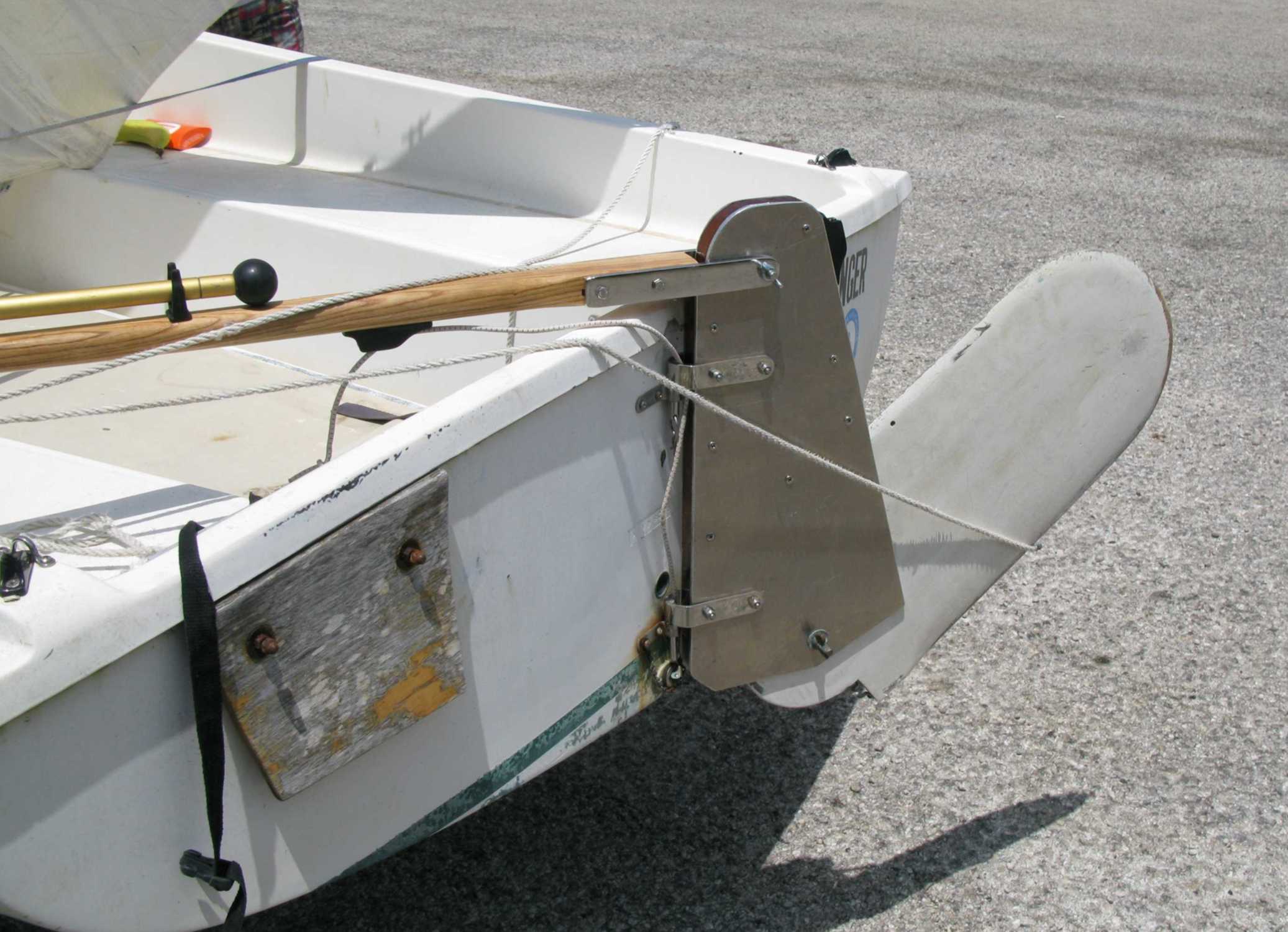

Is anyone else bothered by the fact that you have to put the rudder on in the water and then bend over the transom to find the little hole to insert the keeper pin in the pintle? I was and needed a fix. A small hole, a small clam cleat and a short piece of line - done!
The cleat installed on the aft end of the tiller and a simple pull and it's up and locked. I must have guessed right on the location of the hole in the rudder because it lifts with very little effort.

Postby GreenLake » Sat Mar 29, 2014 8:09 pm
What about a downhaul?
Re: Rudder Lift
Postby thomasglossop » Sat Mar 29, 2014 8:43 pm
The down haul was already part of my rudder. It starts in a hole in the top forward end of the rudder and runs up the forward end of the aluminum frame and exits to a clam cleat on the underside of the tiller.

Re: Rudder Lift
Postby TIM WEBB » Sat Mar 29, 2014 9:34 pm
Thomas, you might want to make that DH cleat an auto-release cleat. Just sayin' ...

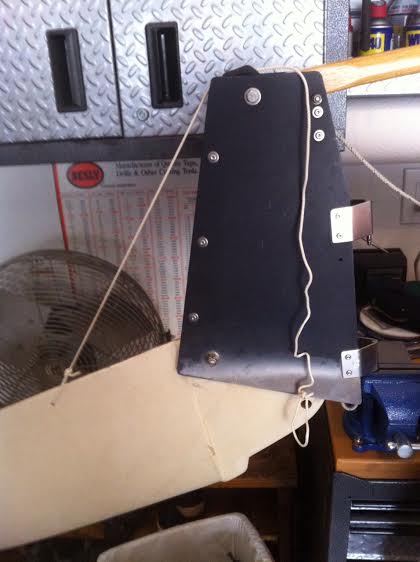

Postby jeadstx » Mon Mar 31, 2014 1:25 pm
I made a new rudder head for my boat to allow the blade to come most of the way out of the water while beaching on the Tx200. During the 2011 Tx200 the blade got jammed while pushing off a beach and the rudder head cracked below the tiller attachment point. Someone with a portable drill was able to drill a hole below the crack to re-attach the tiller. The tiller was at about a 30 degree angle for the next four days of sailing. As a result I made a new rudder head that would allow the blade to raise up out of the water when beached to prevent a repeat of the 2011 problem. I aatached an UH line with a clamcleat with fairlead at the top of the rudder head. I used a clam cleat with fairlead for the DH. I used shock cord with the DH, but plan to switch to an auto release cleat like Tim is using. The new rudder head also allows boat to be launched and retreived with the rudder in place.

Re: Rudder Lift
Postby jeadstx » Mon Mar 31, 2014 1:27 pm
UH was not yet attached when the picture was taken, but you can see the cleat and a hole in the blade.

Postby thomasglossop » Mon Mar 31, 2014 8:18 pm
Hey John,
Looks very similar to what I did. My DH is te same as yours and the auto release is a good solution and only about $21.
Good sailing!
