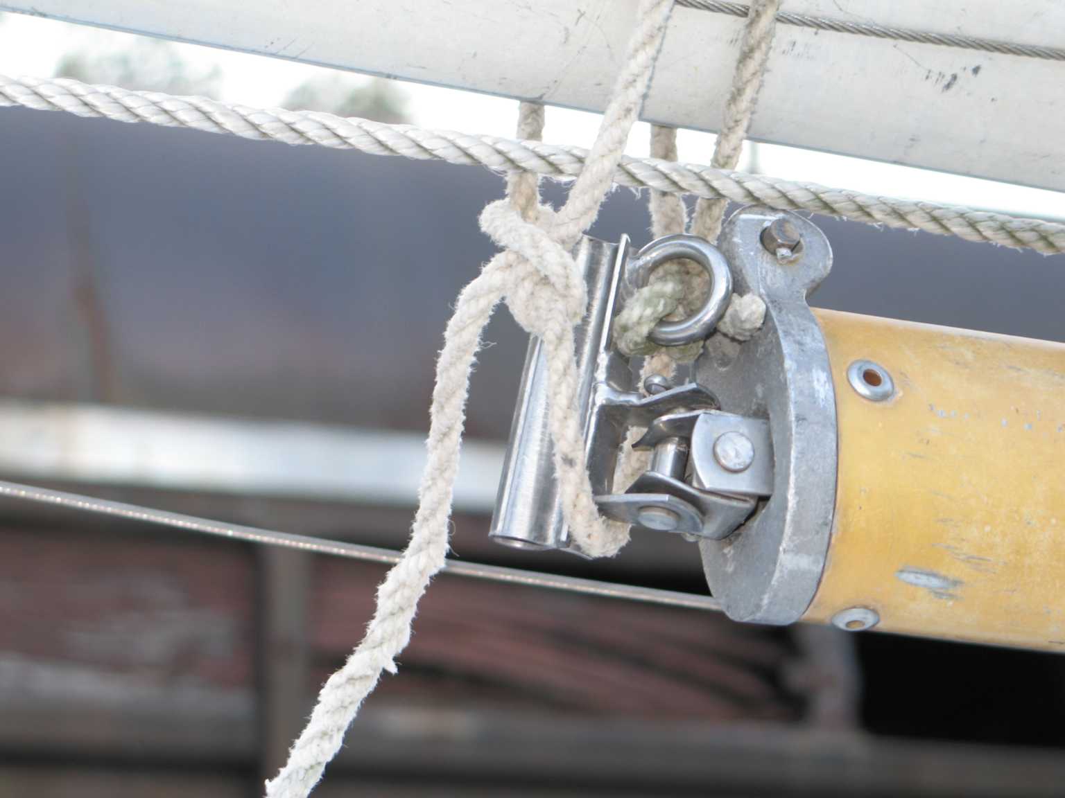

Postby jeadstx » Thu Oct 03, 2013 3:45 pm
Here is the end of my boom.
Boom End.jpg (91.38 KiB) Viewed 10410 times
Re: Gooseneck fastener
Postby Interim » Thu Oct 03, 2013 3:49 pm
Looks like mine, but for the fastener. Perhaps this is my excuse to buy a rivet gun.
--john
1979 DSII
Interim
Posts: 141
Location: Nebraska
Postby GreenLake » Thu Oct 03, 2013 8:17 pm
Nice picture. Mine looks the same (from memory), so apparently no design changes between '63 and your date or one of us doesn't have the original boom...
Postby Interim » Tue Oct 08, 2013 11:17 am
I have a 1979 DSII, which I am trying to get in order for the Spring.
John's picture shows a third rivet. That is, if there is one each on the long sides, there is a third on the short side (opposite the slot). (Mathematicians; sorry for referring to the sides on what is obviously an ellipse).
Mine only has the two on the long sides, so I plan to put in a third. Does the type of metal used in the rivet matter? I understand Greenlake's note about type of stainless steel, but I have this lingering idea that I can create problems by putting the wrong types of metal next to each other. Is that right, or does the 316 SS work ok on an aluminum boom?
Long winter of repairs ahead! Trying to do the mechanical things before I get to fiberglass and gelcoat questions.
--john
1979 DSII
Interim
Posts: 141
Location: Nebraska
Postby GreenLake » Tue Oct 08, 2013 4:21 pm
Boom and end cap are aluminum. To avoid galvanic corrosion you can either use aluminum rivets or use SS fasteners with TefGel (an insulating paste). TefGel is a bit pricy but a really small quantity will last you a long time..
