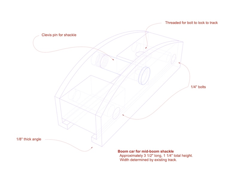

First, to test the boat I just ran the main sheet from the block on the end of the boom to the block on the centerboard. It interfered with the tiller, but not enough to be an issue for the sailing we were doing.
My sail runs in a track in the boom, so simply lashing a block to the boom is not so simple. The sails appear to be brand new, I am reluctant to cut them.
I like the idea of fabricating something. I have tools and some experience. I am curious on your thoughts on the attached design, which is my interpretation of Green Lake's description.
Drawing for a mid-boom car to support a shackle block
Mid-boom car.jpg (53.18 KiB) Viewed 34576 times
I am envisioning the hardware (bolts and clevis) being stainless, and perhaps the angle. But the "spacer" blocks I would rather make from aluminum just because I don't like tapping stainless. But I am curious about the comments on anodizing the aluminum. I don't have experience fabricating parts for boats or marine environments but I have also never had serious issues with oxidation/corrosion on bare aluminum. Is bare aluminum an issue?

Re: mid-boom block car / track
PostPosted: Wed Aug 20, 2025 8:44 pm
RaleighRancher wrote:What about just attaching a boom bail? For example, https://drmarine.com/product/boom-bail-small/
I have a DS2 and this is how my mainsheet block is attached to the boom. Mine is riveted on but screws could be used too.
Yes, that's the obvious answer and the proverbial 99% of people would likely go that route. And most likely the solution I would have chosen.
But, if you want to be different and have fun building things...well, the DS is a fun platform for that.
PostPosted: Wed Aug 20, 2025 9:10 pm
kinnebrooksailer wrote:I like the idea of fabricating something. I have tools and some experience. I am curious on your thoughts on the attached design ...
I'm going to engage you here on the design, based on now much fun it is to see whether you can pull it off, not based on the sound principle of minimal effort.
First, unlike you, I'm not set up to do nice drawings like that, but thanks for giving us a base for discussion. I'll use words to describe how I would alter the design.
  1. For the spacer you can use a piece of any suitable hard plastic. That avoids issues with corrosion.
  2. I had envisioned the sides to be rectangular, if viewed side on, and therefore a single piece of spacer.
  3. I had envisioned some kind of "eye" to attach the block, an eye strap bolted to the spacer.
  4. Now, seeing your drawing, I'm thinking shackle with the pin horizontal through the middle of the whole assembly would make more sense.
  5. Everything else is as I imagined.
(B) your design with the curved sides and a pin does look like it could work. But let's consider some alternatives. You don't need very much clearance for attaching a block, so there would be no need to split the spacer in two. It's easier if this is a single piece. (A) Hard plastic should be enough, the threads don't need to do more than preventing the locking bolt from falling out. And, your design, unlike (C) does transmit the sheet load to the sides. However, as you need a pin anyway, simply get a shackle: so as in (D) do away with the curved side, make the pin of the shackle go through the spacer and use the U part to give you clearance to attach the block. It's both easier to make (straight lines) and stronger.
If you are set up for this work and find it fun, there's nothing wrong with an approach like this and you get the satisfaction of having something unique yet functional on your boat.
