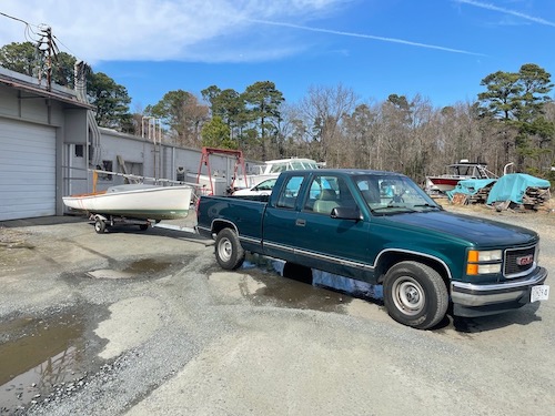

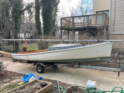

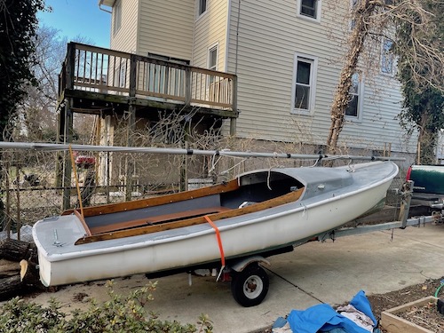

I should probably show you all the boat at this point. Here she is on the day I picked her up from the Chesapeake Bay Maritime Museum, and in my driveway after I got her home. It's raining today but I'll get some more photos once it clears up. She needs paint (not sure what they were thinking with the gray gelcoat) but the seats, coamings etc. are in great shape. She has most of her original hardware except where a few bits have been replaced with what appears to galvanized steel (ugh). She is old enough to have been built without a motor well but someone added one and did a crap job of it so that's on the list for replacement.
