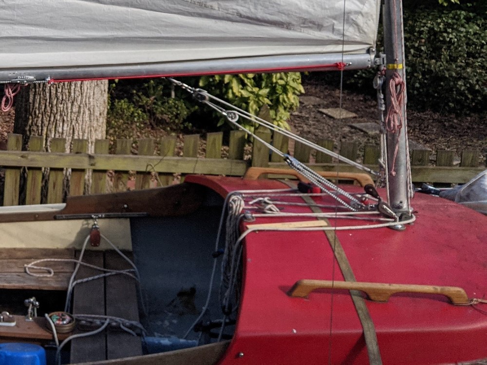

20-1 Vang
Apologies for being a bit out of focus! Anyway, this is a 20-1 cascade, that brownish blurry stick on the cuddy roof is a foot-long ruler, so gives you some scale. This page has some great schematics for various Vang systems:
https://www.ronstan.us/marine5/vang_systems.asp
Mine is Vang #6. I spent about $250-$300 on this, note that I did NOT use Ronstan gear, much as I love them. Instead I looked up the breaking strength for the blocks that they suggested, then scoured the Internet to get used, discontinued, etc blocks with the same specs at a more reasonable price. Ironically, most of the gear in my Vang is from FICO, originally the 'Big Dog" in nautical fittings, till Ronstan bought them out in '81. I splashed out a bit more on the ropes, as I needed light, strong, and low-stretch and wanted new, not offcuts - this combo costs money although not all that badly either. I used Dyneema for the cascades and New England Ropes Bzzz line for the pulley. I did my own splicing, so add a few bucks for the tools (reusable and you can use a coat hanger and needle-nose pliers instead). Also I spent freely - read new stuff and not cheap chinese crap - for the good stainless shackles, including 3 snap-shackles. The latter are not strictly necessary, but sure makes rigging/unrigging the mast a lot easier and quicker. Anyway, I really think that a robust vang setup like this is worth every penny and can be kept at a reasonable cost. And you can go in steps.. for instance, buy yourself a 5-1 pulley and set up the cascades later. Also, you may want to reverse the pulley, put the camcleat along the boom so that you can reach up to adjust it. GreenLake, on this forum does that, although I have no idea how he controls the tail.

Here's a picture. (I only have a single attachment point for both sides of the cascade and can't report any problems with that).
2717267926632328
(click to enlarge)
The pictures show, in order, use of the vang on a reach in 15-20kts of wind, the attachment using a U bail, the full vang and the detail of purchase and cleat, including the 90 degree twisted shackle needed to attach to the bail on the boom. For the latter, I used a SS strap riveted to the boom - works well, but my mistake was a slight error in the angle - and the vang did bend the strap a bit! (It's been stable this way for multiple seasons). Alternatively, a through bolted U bail may have served.
I usually thread the tail through the bowline knot at the other end of the purchase, to keep it out of the way, leaving just a shallow loop to grab.
So, now you have some examples, but I think the older thread on the forum are full of useful discussions.
I think my blocks are Ronstan. I remember the Series-20 6:1 was unexpectedly inexpensive; even now you should be able to get it for $125 list. The cascade is either a 30mm high load or a 40mm block at less than $30 list. I don't think I cracked $200 on this vang, all included. The required SWL on the purchase is 1/2 of that for the block on the cascade. If you use a double cascade, it would be 1/4. So you can to small there.

Love your "upside-down" Vang setup and I'm going to steal the idea of looping my shorter tails to a bowline. I have several controls that are adjusted over a very short range (my topping lift, for instance), this is a good idea for controlling the tails.
What's with the cheek block on the boom (Photo 4)? Cunningham? Slab reefing?
Aha moment! I finally understand how you're using Prusiks (Photos 3,4). I need to re-rig my jib sheet, tempted to ditch my hard shackle....
What's the blue/yellow flecked line in Photo 2? Your jib tensioner? You lead it thru a plate, doesn't that wear out the line? Another nice Prusik, though.
Mad love for your red-capped crewman in Photo 1! Wrestling the live end of the jib sheet, wrapped around his hand, in 15 knots wind, gusting 20. I need fearless crew like him, if he ever gets sick of the West Coast, send him my way. I promise a steady diet of Carolina Barbecue, Cheerwine, and Bourbon. Happy crew = Happy sailing!

But, as we are on the topic of rigging. Photo 2 was indeed taken to document my jib tensioner. It's lead through a fairlead that's similar to a low-friction ring. If the tensioner is adjusted a lot and with big changes in length, perhaps it might try to saw through that, but as it is mostly stationary, it feels the same curved surface as on a small block. I predict a log and happy life for it. (Should be mounted closer to the mast, so it doesn't pull the halyard off.
The Prusik for the jib sheet works well. Should have been a bit narrower rope for it, but somehow it jams so tight, it doesn't come lose even with flogging sheets.
The cheek block is needed for my single line reef. I'd say, mount a hook on the gooseneck if you can figure out how, and forget about the reefline for the tack. Just have it for the front. The way I have it, I need to first reach under the boom, pull the rear tight, then tighten the front. Still, it works, as you saw on the first photo.
