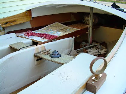

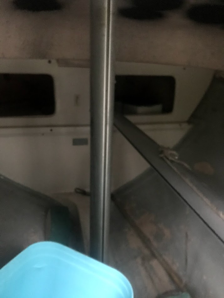

I'm just getting back to boating after a long hiatus, and there's a local daysailer that I just looked at. I've been reading through a bunch of info on this site, which has been fantastic, but can't figure out what's going on with the cuddy of this boat. I was hoping to find enough space below to camp in a pinch, or at least for my son to curl up in, but when I looked in, I found a bulkhead with storage above and presumably flotation below located a few inches forward of the stepdown to the foredeck, leaving less than 4 feet of space forward of the hatchway. Sorry for the cruddy photo, but it was raining like stink today.

This is what I had anticipated seeing:

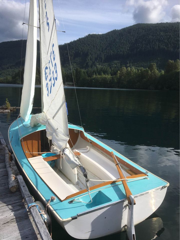

And this is the rest of the boat, hull #20249, Class #3733 on the placard:
So is the plywood bulkhead above structural? I'd be hesitant to remove it if it's adding integrity to the foredeck. But even if I remove it for footroom, it seems a bit high to build a platform back from the fiberglass part for sleeping. The boat needs some redoing anyway, since I can feel waterlogged styrofoam through the drain plugs to the seats, but the boat is otherwise in great shape, and has a nearly new trailer.
Any thoughts on the bulkhead?

What's missing in the first picture are the set of wooden floorboards that were factory provided for the DS1. The boat can be sailed without them, of course, but having a bit of a platform, even as shallow as the floor boards, would provide a bit of level surface in the cuddy. (The floor boards would rest on either side of the keelson and be almost the same height; a sheet of plywood with a bit of supports could be made so it rests on the keelson in the middle and then meets the hull on either side in a sort of curved triangle shape; it would provide a level surface and prevent any small puddle in the bilge from getting your gear wet).
With floor boards, or something like them, small children enjoy the space. A waterproof duffel filled with clothes, a spare life jacket and the odd cushion seem to be sufficient to build a "nest" where they can rest, sleep and otherwise while away the time to the next landfall.

The plywood bulkhead in the cuddy opening will stiffen the boat (and help keep your gear dry in case of rain), but it is not factory original.

That boat is a DS1, with a wooden bulkhead added at the cuddy opening by some previous owner. The forward bulkhead is in the same place as other DS1's, and yes it's about 4' from cuddy opening to for bulkhead. Your second setup is a DS2, a different beast entirely, as it has a false deck and bilges underneath. More on that in a moment...
Depending on the exact vintage of the boat, the DS1 has either a full forward bulkhead, a "shelf", or a shelf with a false bulkhead above with some hatches for storage. Your's appears to have the last option. The fore bulkhead is mostly there to hold foam flotation blocks, it's not structural. Note that I wrote BLOCKS, the flotation is nothing but big styrofoam blocks, which eventually (years) get waterlogged. So, right off the bat, I'd say you can take out the foreward bulkhead if you want and gain more space, but.... #1 you have to put the flotation somewhere! You could just reverse the order though, keep the "floor" clear for your son and put proper two-part liquid foam along the roof. #2 How much are you planning on being up on the foredeck? It does in fact flex, the support underneath is nice to have. That being said, in two seasons of sailing, I've been on my foredeck two-three times max. Of course, I have a jib downhaul, so no need to go forward while underway. However, with both those points in mind, I caution you that there is not THAT much useable space forward of the bulkhead along the deck, maybe 10 inches before it narrows too much. There's more room at the top behind the bulkhead, maybe 18 inches? Really not much, I don't think the "juice is worth the squeeze". As you photo shows, the DS2 puts the forward bulkhead further forward and therefore has less flotation foam. That's because the added flotation is under the false deck, not sure if there's foam down there, but there is at least a big bubble of air. Not much help if you're turtled, but that explains the smaller bow flotation. As I wrote, your're really not gaining that much.

The small forward bulkhead with the two small openings is structural. If you simply remove it, you'll have to add strength somewhere else.

Well, we basically agree that one shouldn't remove the forward bulkhead, build around it.

well, you can remove it, but then you need to support the cuddy opening instead, e.g. with a stiff hardwood arch.

Good luck on the buy! GreenLake is correct, of course.. if you are going to take out part of the fore bulkhead, then put in something to support the foredeck. I wasn't emphatic enough about that in my prior writings. Maybe a post in the middle and a brace under the deck. The Daysailer bylaws also specify that you must support the foredeck:
5.7. The forward bulkhead may not be removed, unless it is replaced by an equivalent deck-supporting device to take its place; however, the two closures may be removed from the bulkhead.
