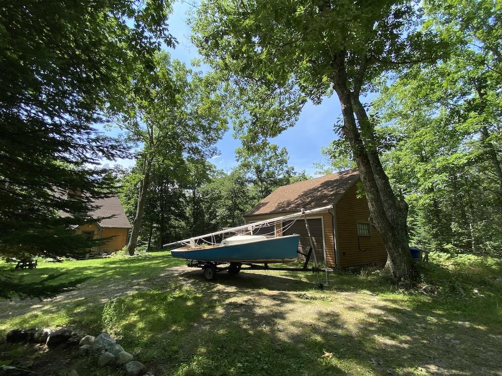

Just picked up a DS1 here in Maine. It's in good overall 'user' condition. The price was fair at $950, on a trailer with some spares.
Does anyone have a recommendation on an outboard for it? I don't wan't to spend a ton, but I also need to be able to move the boat if need be...
