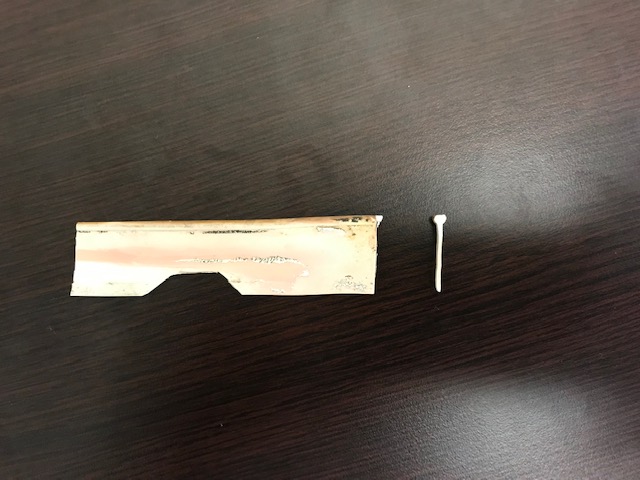

Postby Paddyt » Mon Jun 24, 2019 6:36 pm
I just took the coaming off my boat and this was between the deck and the wood. I think it must be the original gasket and when it was on it formed a very tight, neat looking seal. I think my chances of finding a new replacement are slim, so thanks for the suggestion of the closed cell tape.

Postby GreenLake » Tue Jun 25, 2019 12:53 am
Closed cell foam will probably give a better seal, without the visible 'bead'. DS's don't have to be museum pieces :).
