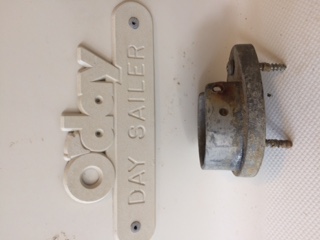

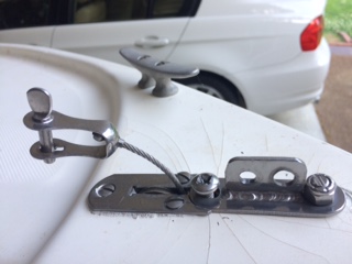

I've got her cleaned up enough to start work. While cleaning I found the mast step in all the trash. With the cabin sole clean I can see there are no screw holes. The step was obviously epoxied in place previously. The mast step has two screws through it as the photo shows. What is the preferred method of attaching it? Screws only, epoxy only or both? I'm concerned about screws damaging the support between the cabin sole and the hull. The second photo show the fore stay chain plate with a shackle on wire role coming through a sheave. There is about 3 feet of wire rope that goes into the cabin with a large fiddle block on the other end. Is this a Jib tension adjuster?

Postby Alan » Thu May 10, 2018 2:17 pm
The forward part of the chainplate looks like original equipment. The aft (through-deck) part isn't original. I'm guessing it's a jib cunningham, which tightens the fabric of the jib along the luff. The shackle looks like it's meant to go through the tack of the jib.
I would guess that the becket block underneath is part of a purchase setup that allows you to adjust tension of the cloth along the luff (as opposed to the luff wire, which is tensioned with the halyard). If there's an unexplained block in the rest of the stuff that came with the boat, that might be the other end of the purchase.
Here are a couple of links:
https://www.jet14.com/jib-cunningham
https://coliesail.com/420-jib-cunningham.html
That's a pretty sophisticated setup - somebody put a lot of thought into it.

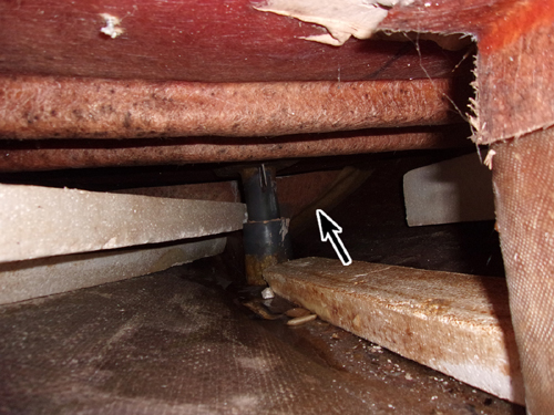

As for the mast step, mine is attached with screws and I haven't had any problems. In the second photo in this thread, which is taken through one of the ports in the cockpit sole, you can see the screws extending downward into the bilge, above and to the left of the arrow. Ideally, the step would be directly on top of the compression post, but apparently a lot of compression posts were installed in a somewhat carefree fashion.
