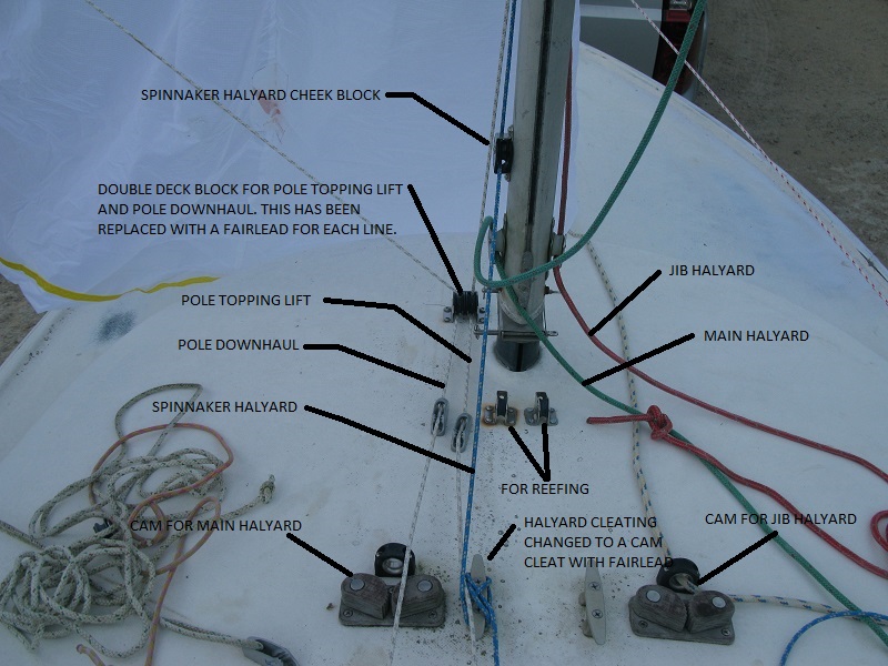

I run my halyards through the check blocks at the base of the mast, then to cam cleats with fair leads located on each side of the horn cleats.
Here is a picture of my DS II. The cam cleats shown are from a 1968 )'Day Mariner 2+2 (dad gave me his old used hardware). My DS I is being setup similar, but I'm using new Harken cam cleats with fair leads.
Spinnaker Deck Layout - Lables.jpg (173.75 KiB) Viewed 14187 times

Postby 1987DSPrecision » Tue Jan 17, 2017 9:08 am
Thanks John, that looks much more convenient for singlehanded sailing.
Any issues mounting those cheek blocks to the mast?

Postby jeadstx » Wed Jan 18, 2017 3:51 am
The lower check blocks are original to the boat. The one for the spinnaker I added, drill a couple holes and rivet in place. Same way the lower ones were done.
I route everything to the cockpit. Really helps when single handing. I try not to have to get on the foredeck, even with crew.
