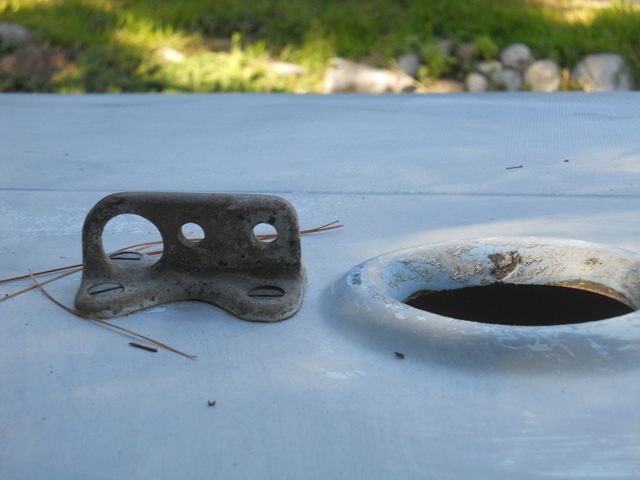

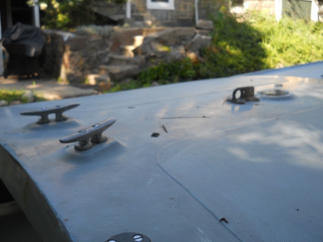

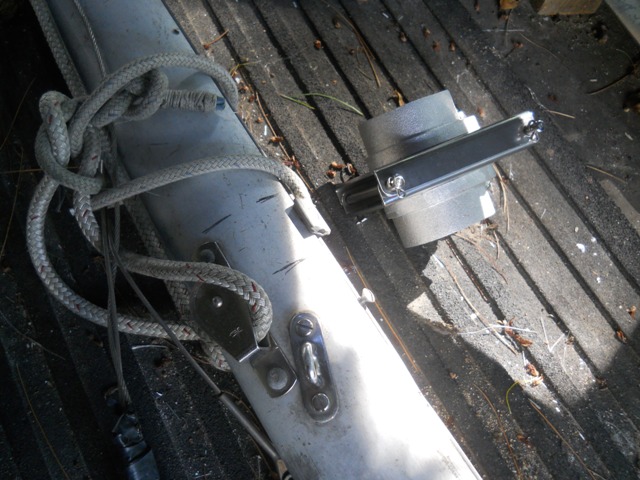

I will be sailing single handed on my 68 D/S 1 and am looking for a way to raise and lower the mast by myself. I bought the folding hinge from D&R marine but haven't installed it yet. When I measure, I'm supposed to cut the mast where my halyard blocks attach. There is a fitting on my cabin roof behind the mast hole that I thought was part of a tabernacle or something but the previous owner told me it was where to belay the downhaul. I'm not sure about that. Posting some pics to check out. Are there any other single handed sailors that can recommend any methods that are already working? Thanks for reading

The fitting aft of the mast looks to me like a stem fitting, typically located at the bow (stem). Here is an example: http://www.racelitehardware.com/rl389stfi.html
In your case it looks as though it might have been installed as an anchor for a boom vang. Although, as the previous owner said, it may also have been used to secure the downhaul. If it was used for the boom vang, I would suggest not using it for this, because it puts a lot of unnecessary load on the deck. Better, in my opinion, to affix the boom vang directly to the mast as low as possible.

If you are looking at a hinge for your mast, I would suggest looking at pictures of the DS II boats, many have hinged mast, including mine. The boom downhaul cleat is screwed into a aluminium tube in the mast slot above the hinge. It is adjustable in height, screwing in the cleat is what tightens it. On the lower section which stays attached to the tabernacle at the base of the section, the boom vang is held in place by an eye loop at the front just below the hinge with a line looping thru it to attach the vang to. An alternative way to attach the vang is by using a bail attached to the lower section, using a shackle to attach the vang. D&R sells the bail.
As mentioned, the hardware shown looks like an old stemhead off some boat. Personally, I wouldn't attach the vang there.

Thank you all for your advice- Last week I cut the mast and installed the hinge. I re-located the halyard cheek blocks to just above the hinge. I also rigged a temporary tackle that attaches to my stem head and uses a spare block I had lying around. I loop one end around the mast just above the spreader bars and run the other end thru the block and back to the cockpit. I walk the mast up with my left hand and pull the line with my right and found this easily raises the mast. I would not try this with the boat in the water. I also found the mast did want to lift up off the mast jack and to drill and pin it would defeat the purpose of the mast jack, so I tied a hitch around the lower mast and belayed it to the mast jack bolt to solve that unhappy occurrence. I agree that the fitting on my cabin roof is an old stemhead from somewhere and have removed it for now. I was so happy with how it all turned out I kept going and made a set of boom scissors from some spare wood and a nut and bolt I had in the basement- cost $0. :D Thanks again to everyone for taking the time to respond, great advice from all !
