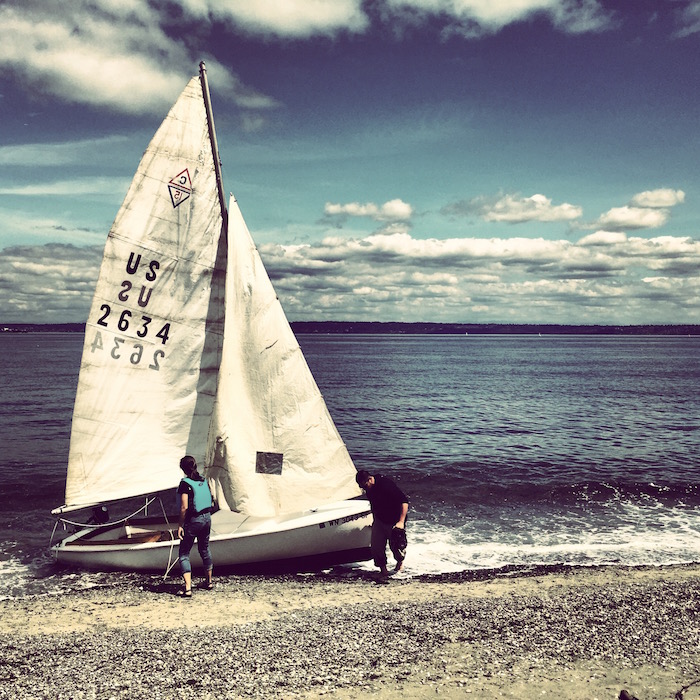

First, a photo from the maiden voyage. We sailed across the sound from Shilshole Marina in Seattle to Bainbridge Island:

I'm not sure what year the boat was made and couldn't find a hull number anywhere, but I think it is a very early model on account of the wooden benches. Any guesses as to what year it was built?

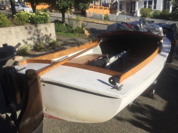

Here's a view of the boat on the trailer which shows more of the details:

Nice boat. Somewhere the boat seems to have acquired a set of sails from a Coronado 15.

Your boat looks like all the original Daysailer 1's I've seen with the wooden benches and the molded lines in the deck. Without a sail number it is hard to guess the year, but I would put it at around 1959. Overall it looks in good condition.

On one of the pictures is looks as if the rudder blade has been installed backwards.

The rudder. Looks hand-built (well, OK, it doesn't look anything my DSII). GreenLake, I'm thinking you're right that the blade does look like it's backwards - to me, it looks like a centerboard installed backwards.
The shield next to the jib sheet cleats. A puzzlement.
Standup spinnaker blocks on the aft corners. Was this a racer, once upon a time?

And another puzzlement: The wood across the top of the cuddy opening. Doesn't appear in most DSI photos, but neither do the wooden benches.

This boat is an enigma for sure. Very early DS no doubt, with lots of "mods" along the way ...

There's currently a listing for another early DS1 out there (just a few clicks away by search) and it matches this one in several features. So, assigning it a tentative '59 doesn't seem to be an issue. Which of the items shown are original and which are not, that would be the question. My knowledge of (very) early DS's is entirely second hand (mine being a relatively "late" '63)...

We have the same vintage DS 1 at our club and over the years the hardware has been updated and modified which seems to be the case of your boat. Evidently the previous owner was a talented woodworker since all the wood seems recent along with a strip along the trailing edge of the cuddy...probably to cover up some damage to that area. The rudder cheeks and tiller also seem to be recent.
These boats were well built and the boat at our club is a very competitive racer

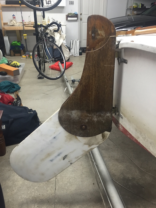

After some hack sawing I managed to take the rudder apart and turn it around. How does this look?

Postby GreenLake » Fri Jul 24, 2015 3:25 pm
Does it swing the 90 degrees?
Your bolt holding it is rather small, so it might take quite a bit of tightening to keep the rudder down by friction (perhaps that was the reason the PO reversed it ?? ).
Anyway, a downhaul could be rigged if it proves a problem. On mine, I need to use a pair of pliers to go a bit beyond finger tight on the wing nut, then it works fine.
