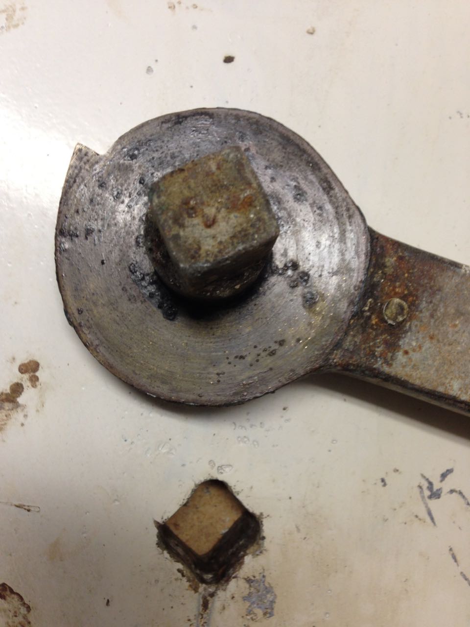

A "sagging" CB for the DS1 usually means that the square hole into which the handle fits is no longer square. It can be squared again by inserting a shim bent from a suitable metal. Trying to achieve the same effect with fiberglass won't work.

Following up on my last post, I've now begun work on my sagging CB. I took the handle off today and removed the CB. There is quite a bit of fore-aft play in the handle, and after inspecting the handle "axle" and the square hole it appears both have worn to create this play. Greenlake, I want to try your shim suggestion, but I am not sure how to go about this. Do you mean to try inserting a shim with the CB in the trunk or with both handle and board out? In either case, is there some way of attaching such a shim to the inside wall of the hole (or to the handle axle)? It seems I would have to do that in order to make it work. Would a thin stainless strap, bent appropriately, be an appropriate shim material?

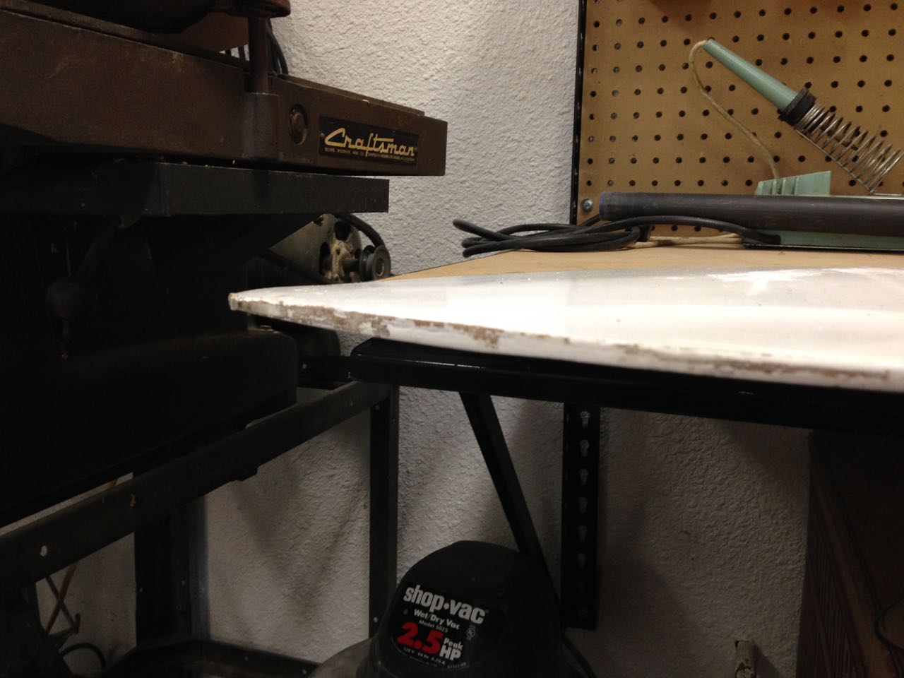

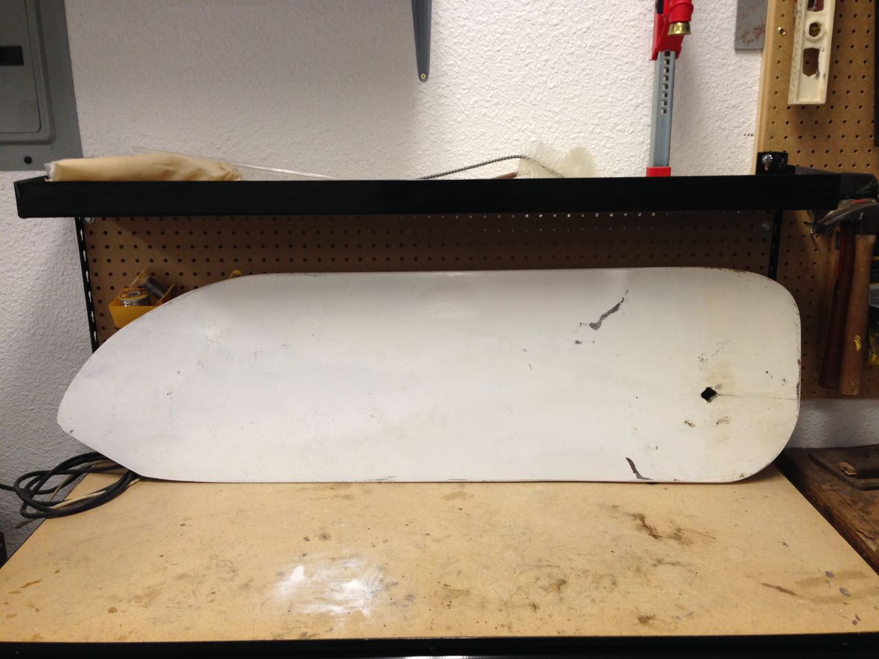

I've included several photos of the CB and handle. After taking it out, the orientation of the board struck me as strange. In the first picture, I have positioned the CB on a workbench as it would be in the fully up position in the CB trunk. This position has the angled, straight section (second photo) at the lower, leading edge of the board. Is this correct? I figure it must be because the board was clearly made that way. Assuming this is correct, it seems strange that this angled section would have a flat edge (about 3/8" wide) rather than be fared in some way. Can someone confirm that this is how it should be? Are there class rules about reshaping this section? While I have the board out I will be repairing a few dings anyway.

Here's the photo of a new DS1 centerboard from the D&R Marine website. The shape is similar to your board's, but the angled section is curved, while yours looks straight.
Is it possible the angled section on your board got its flat edge from scraping on the trailer? That's most likely what happened to the leading edge of the board on my DSII.

Thanks, Alan, for the link to the new CB photo. The flat edge on mine looks like a finished edge, not something that might have been caused by scraping on the trailer. There is still some paint on it. In any case, I will probably reshape it to look more like the new CB.
As for correcting, or "re-squaring" the slot for the lever, all I can think of is shaping an appropriately sized (using the lever arm) square metal insert for the slot (I have some sheet brass that might work for this), then using epoxy to secure it into the slot, filling in between it and the wear and tear "expanded" portions the slot. Does that sound like it could work?

Angled section: there is no way this is intentional, and if it looks painted,then it's been touched up. The original CB just has gelcoat.

Finally, I am still working on a shim method of creating a tighter fit between the CB handle "axle" and the slot in the board. The corners of that slot had expanded outward slightly and rounded, which is creating the slop and consequent sag in the board. I have some sheet brass and aluminum (I think) both about 1/32" (or less) in thickness. I tried cutting a strip of the latter and shaping it into a square using the handle axle as a mold. Then I inserted this into the board slot. This improved things but still left too much play. Am I on the right track, do you think? If I use a longer strip of the metal, I may be able to create an even tighter fit. If so, would it make sense to epoxy that into the slot, trying to "back fill" the sloppy corners. Or perhaps fill the corners first, then file them to 90 degrees once hardened?
