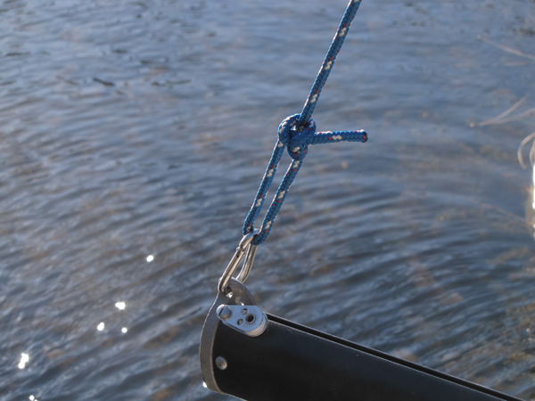

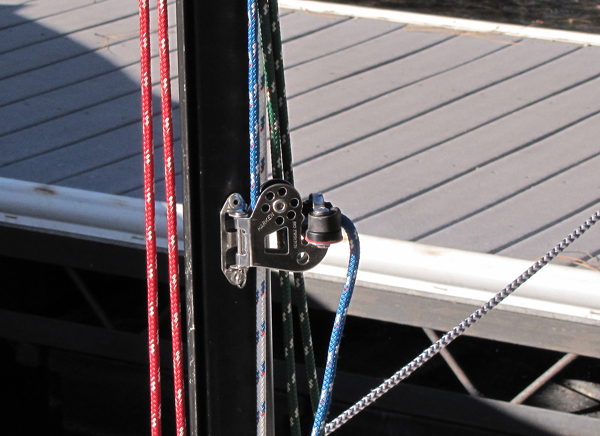

My setup has the topping lift line attached to the aft end of the boom with a carabiner, running over a cheek block at the top of the mast, and down to a swiveling block/cam cleat on the mast. I used it last week for the first time and I'm really happy with it. Most of my topping lift adjustments happened while I was also doing other stuff at the mast, so having the cleat there is convenient.
You can pull it tight and also pull the mainsheet tight when the boat's rigged but not sailing - that way the mainsheet and topping lift will pull against each other and hold the boom in one place. When you sail, you loosen it a bit so it doesn't interfere with the mainsail shape.

Full credit where it's due: My basic setup design is borrowed from Roger Conrad, author of the DSII book on this forum, who wanted to be able to adjust the topping lift when the aft end of the boom was out to one side or the other, out of reach from the cockpit. All of my adjustments have been made from within the cockpit, so I can see his point.
The bowline at the aft end was done in haste, along with a lot of other stuff on the way to a longtime pre-arranged vacation. It works pretty well, but I'd really like to find a way of adjusting the topping lift from the aft end of the boom as well.

Alan's setup can be improved by replacing the bowline with a rolling hitch (or one of its cousins). That would allow some adjustments to be made while standing at the end of the boom.

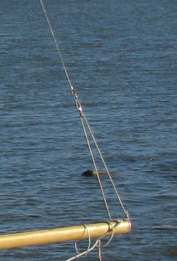

My topping lift was made from a section of a O'Day Mariner backstay (3/32" SS cable). I put a SS tang on the masthead and bent the end of the tang an angle to line with the transom. I attached the old backstay end section (with a clevis pin) to the tang. The other end I attached a ring with a carbineer snap hook. it came to a point about two feet from the end of the boom (where the boom would sit with the sail up). I then attached a line to the end of the boom, ran the line thru a small block and then thru a cheek block on the end of the boom. I put both a small plastic horn cleat and a clam cleat forward of the cheek block. The small block attaches to the snap hook on the end of the old backstay segment. When sailing the line is loose so the topping lift will not interfere with the sail. When at dock or motoring, I can pull in on the line to raise the boom out of the way.
