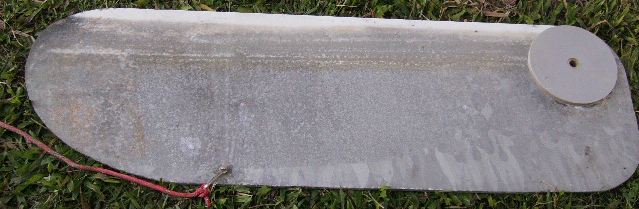

Gidday all from down under . I have finally managed to careen my Aussie DS1 and removed its Galvanised Steel centreboard. I was shocked to find that it is in very good condition. I thought that others would like to see its specification :-
DAYSAILER CENTREBOARD
LENGTH: 47 5/8 INCH 1210MM
BREADTH: 15 INCH 380 MM
THICKNESS 3/8 INCH 10MM
BOSS AT PIVOT : 1 5/8 INCH THICK
WEIGHT: 70 LBS
CASING DEPTH: 16 ¼ INCH
I would welcome suggestions as to how I can arrange a lift mechanism for it given the weight of 70 LBS ! All it has at present is a single pulley wheel giving no mechanical advantage. The clearance in the case is a little over an inch .

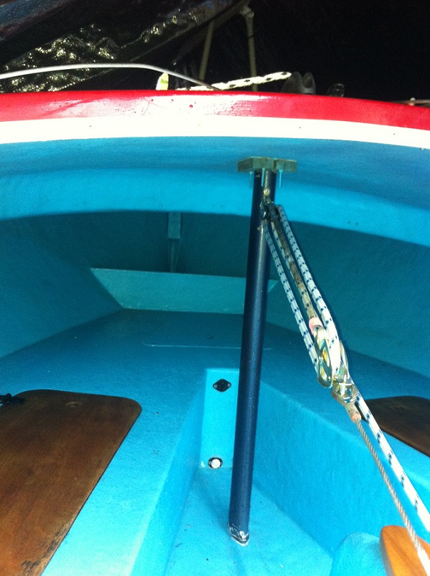

Postby brad » Sat Jun 08, 2013 3:22 am
Hi,
I am not sure about the Australian Daysailer history, but I believe they were made in Brisbane , Qld, in the late 60s or early 70s.
They would be no match for their northern hemisphere cousins in the speed stakes – I reckon they were built for cruising. ( I have yet to get mine up onto the plane). Whoever built them down here made them incredibly strong and very,very heavy. It also seems that centreboard case has additional strength built in to support the galvanised steel centreboards.
This is the system on my boat - my centreboard is also just a cut piece of flat plate steel like Graham's.
The centreboard is raised by 3:1 blocks.
I have pondered about replacing the current set up with a proper profiled board. The boat is not spectacular upwind, but I imagine the sails on my boat are the originals. New sails would most likely assist greatly. Its just great to cruise in.

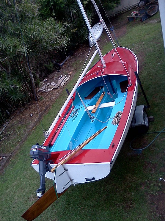

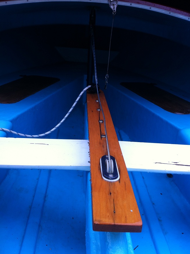

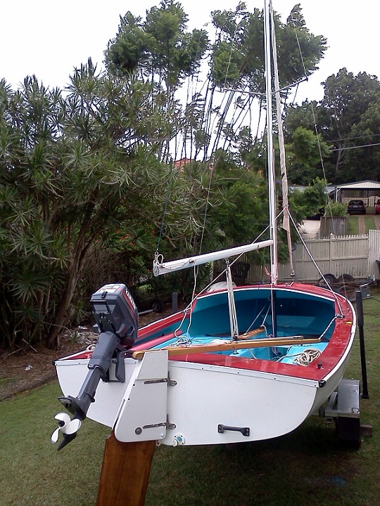

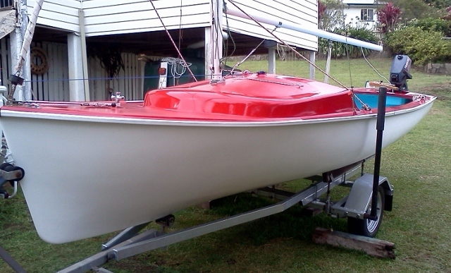

Postby brad » Sat Jun 08, 2013 3:34 am
Here's another couple of views of the Aussie version

Postby graham5494 » Sun Jun 16, 2013 4:05 am
The pictures uploaded by Brad resolve my centreboard problems completely . As they say .... a picture is worth a thousand words ! Certainly this forum can save its members much time and effort !
