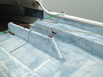

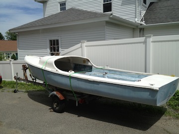

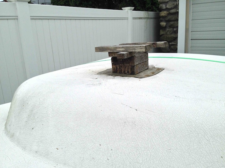

Hello,
I am a new O'Day Daysailer I owner. The previous owner did some "creative upgrades" to the mast support structure on the boat (see the attached images). I am hopeful that someone has information/plans/drawings/specs for how the mast was originally positioned/supported in the boat. Any info, preferably with pictures, would be great. Thanks in advance.

Welcome to the forum.
Check out the Gallery, both for individual users and the common Daysailer pictures.
You will most likely find a number of photos that show mast supports.
There seems to have been a cuddy deck reinforcement to make it unnecessary to have a compression post. That could work, and if it does, there would be no need to change it. (If the deck flexes as you tighten the stays, that might require work).
The point of all that wood on top of the cuddy escapes me completely.

Based on the pictures in the galleries, it looks like they also leveled the floor hiding the substructure and the normal compression post mount. All that wood seems to be what they expected to hold the bottom of the mast in place. The is no other structure there. How long is the mast normally, I'm worried they cut it.

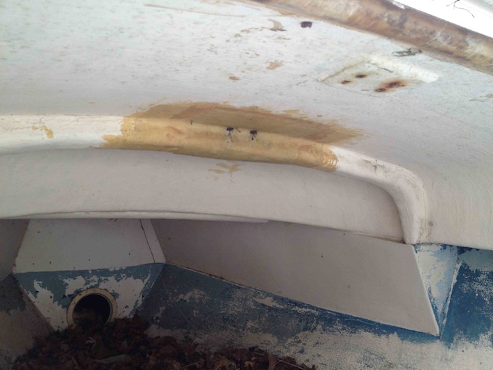

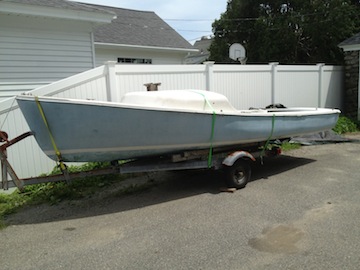

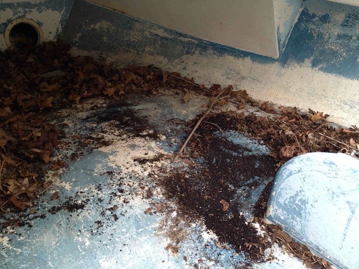

Okay, I think I have the pictures you need.
3
2
1

Postby randomlogic78 » Wed May 29, 2013 12:31 pm
Last two...
5
4
randomlogic78

Postby jeadstx » Wed May 29, 2013 1:01 pm
Looking at it I think you have an American Fiberglass Corp. (AFC) Discoverer 18.
