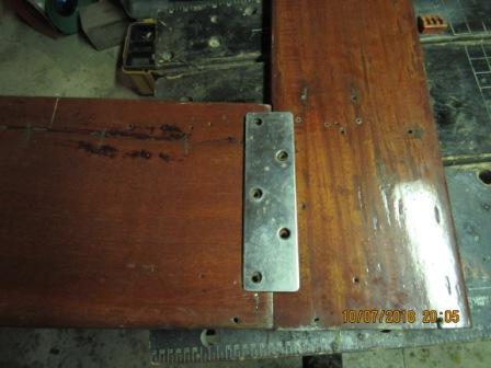

Attached is a pic of the seat/thwart bottom: one w/o the tie plate and one with the plate. I believe the 5 large through holes were original by O'Day for the connection. You can see the many wood screw holes that were drilled for the door hinge type connections. I trust that the new bracket with through bolts will work better.

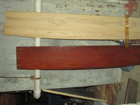

Also attached is a shot of the new seat next to the original seat. I think the original seat material is not mahogany since that is not as strong as say teak or ash. Plus a plank that wide in mahogany would be very expensive. I'll try to use the old seat material for other purposes.
10-19 Seats old & new.JPG (26.33 KiB) Viewed 9234 times
I 'm not sure how the ash seat will work out w/o intermediate support. I see no sign that there was such support on my old seats. If I need the more support between the thwart and stern rail this can be added later. I would be curious if you have any detailed shots of those supports (cleats).

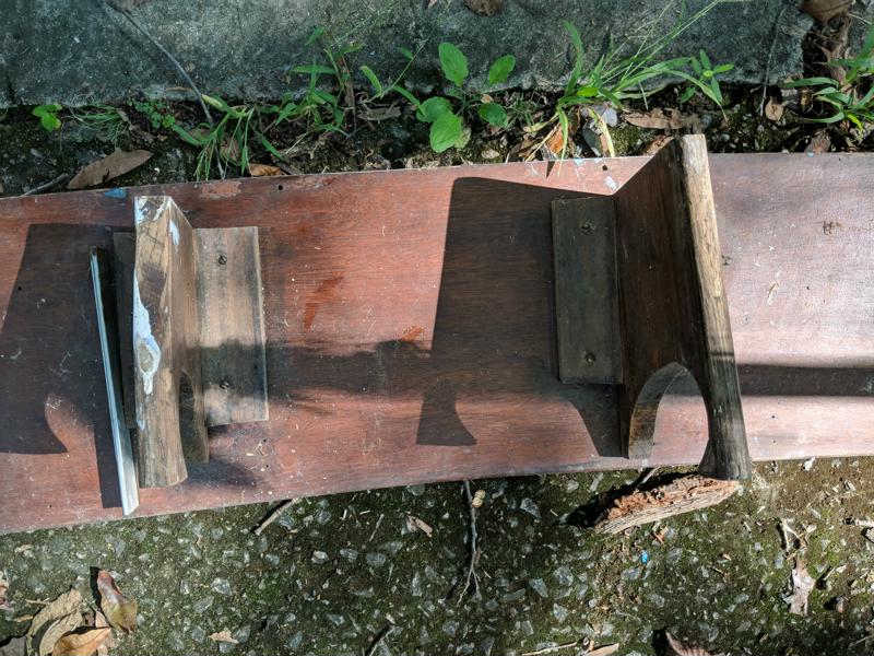

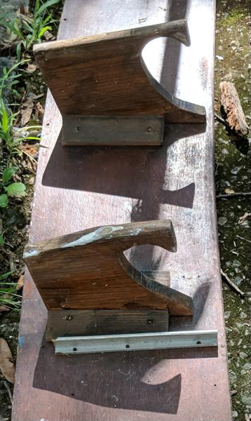

Apologies for the delay on responding. I've got some detail shots of my original seat supports below. One semantic note - my "cleats" are simply the 1"x1.5" 7-foot long strip of wood screwed to the side and aft bulkheads (flotation tank walls) to hold up the outer edge of the seat and thwarts.
Anyway:
Seat Brackets
The metal rail is for an under-seat storage drawer.
Seat Brackets 2
The brackets were held in place by wood strips (cleats!) on either side. Cleats and Bracket were glued and screwed to the underside of the seats. The brackets are 7/8 inch thick, about 10 inches wide (fore bracket) and 8 inches (aft bracket), and vary in height. The fore bracket is 10" high at the front (actually more amidships once installed in the hull) and 8"ish at the back (outboard). The aft bracket is 8"ish and 6"ish. I can remeasure if you want, but you're better off making a template for your own boat, especially because these brackets also follow the curve of the hull.
Let me know if any way I can help. I took apart my seats to use as a template/jig for cutting out the curves in my new seats - it took multiple passes with a borrowed router. But I can still take measurements, trace and upload templates for you, whatever you need.
For what it's worth, I finally finished my new seats and they are hold up rather well by just the bulkhead cleats and the steel plates connecting them to the thwarts. In other words, it's supported on 3 sides and they don't flex in the middle when I sit there. Still think that one support bracket in the middle would be a good idea, I need to sail some and see.
