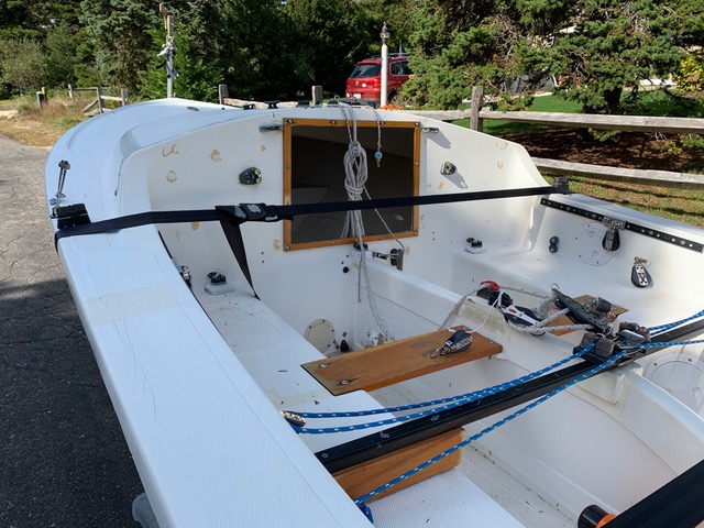

Hi - I've been watching your project and progress you are making. Think this is a really good idea.
I'm going to make the bulkhead removable if you need to do repairs. It wouldn't be very pleasant to have to crawl through the hatch and try to make repairs in such a small space. Maybe it is that I don't like confined spaces much.
My SLI Daysailer has a small hatch, I am 6'1" / 175 lbs and crawling in and out is a real PIA and when you are in there it is very small indeed.
Rob
DS1 #2444

Looking good, and a very ship-shape hatch! That being said, and with all due respect to RobH, I am 6'1" and 260lbs and there is no WAY I would dare to go thru that hatch. I suppose you can reach in and grab things, as long as it hasn't wandered off the for'ard bulkhead. How do you plan to drain out the inevitable water? Can still get in thru the mast partners, even if (miraculously) nowhere else.

Lemsteraak - I've seen pictures of what I think is the original SLI hatch cover, looks nice... a plastic raised "box" that opens outward and also looks like it would seal well when closed.
Some where along my boat's life I am assuming the original hatch broke and a previous owner of the boat replaced the hatch with a piece of painted marine plywood hanging down from hinges from the inside the caddy. It swings inward into the cuddy and is held open with a clip on to some bungee and closed with a cleated line running out of a hole in the bulkhead to the cockpit.
You clearly have very good wood working skills so you'll be able to build a good hatch for your SLI DS as well.
Tom - yes felt a little like a Houdini trick getting in & out of the hatch and thought about going to see my chiropractor afterward. :shock: Not going to do that very often...
