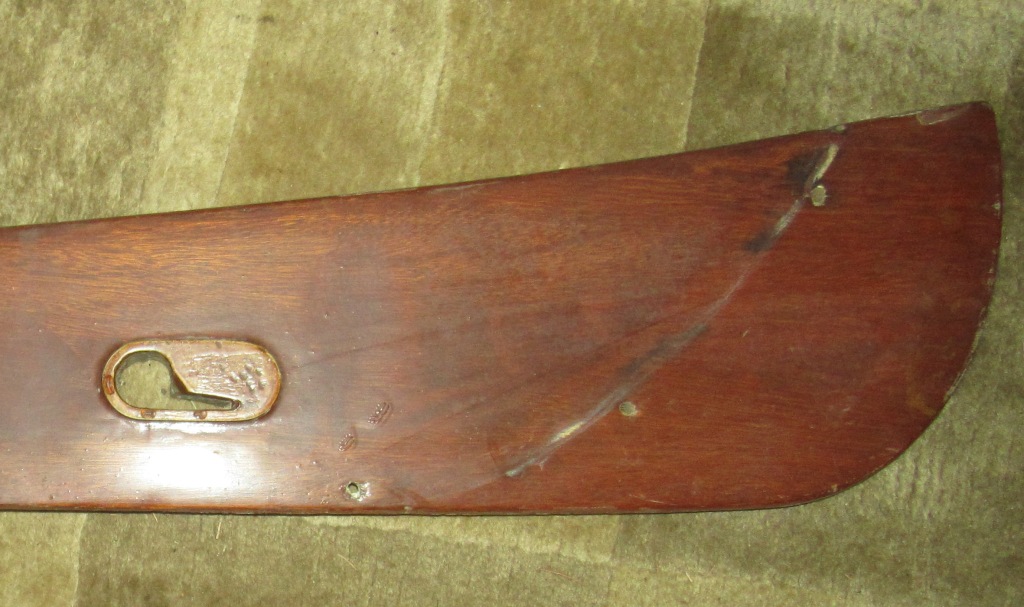

Re: Cockpit trim question (cut or remove)
Postby Cliff » Tue Dec 24, 2019 2:18 pm
A pic may explain it.
Starboard Coming.JPG (184.79 KiB) Viewed 16180 times
Cliff
Cliff
Posts: 69
Location: Andover, MA
Postby GreenLake » Tue Dec 24, 2019 6:12 pm
Nice. These look like combination thru-coaming/cleats.
You are right; they don't allow fore-aft adjustment, but if I believe my sailmaker, he felt that in/out adjustment was more important.
That's an if.
