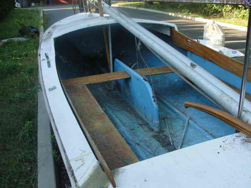

Postby Cliff » Tue Oct 02, 2018 3:00 pm
Sunbird Seat & Thwart 2.jpg (38.72 KiB) Viewed 19478 times
TY for the in
My thwarts are in two pcs 29.5" long each. The thwarts connect into the centerboard housing at a seat fiber glassed onto the CB housing and to a wood rail along the side which supports the outside of the seat as well.The end of the seat buts flush to the thwart. I found a picture on the forum site by "Sunbird" (attached) but can not see the way it is connected below. There are two bolt holes on the thwart and three parallel on the seat. I believe these were by the Marscot Plastics but when I got it, it was held together by what looked like an old screen door hinge. Looking at the bottom of the seat it is filled with many holes. I bought the boat 2'nd hand in the early 70's. (Hull # 2018)
My original mahogany seats are split, held together by some funky picture frame type brackets. I've had new seats milled from hardwood about 20 years ago but never replaced them. The boat was last registered in 1992. Used to moor it at my camp on Newfound Lake in NH (no longer own camp). Am I a procrastinator?? you bet but I'm retired now and wish to put the old boat back in service.

Have had seats milled out to rough shape. The wood is a hardwood laminated longitudinally. The inside edges have been rounded and now need to do some fine shaping to the area of the thwat. Now have a good idea for the joint.Expect to use a metal (SS) one piece bracket drilled to match the large (3/8" dia) holes in the two pieces. The inside of the seat has no supports between the Thwart and the stern rail support.I believe that the original boat was free of supports also but when I last sailed it I felt it could use at least one intermediate support. I see on your pic you have some intermediate supports.

Re: Thwart repair
Postby tomodda » Tue Oct 02, 2018 3:24 pm
Procrastination - Never put off until tomorrow that which you can put off until next week!
Anyway, sounds like your only problem is how to connect the seats to the thwarts. Ditch the screen door thing and get some deck joining plates from the HD, rummage around you'll find the right piece (big rectangular plate). They are meant to be nailed, but drill some of the holes out and screw them instead. Yeah, they are galvanized instead of SS, but you wont see them and they wont rust. Spray with some rustoleum if you're worried and just check them every year or so.

Postby Cliff » Tue Oct 02, 2018 4:32 pm
tomodda wrote:Procrastination - Never put off until tomorrow that which you can put off until next week!
Best,
Were the supports along your seats original? I just went to the basement and measured the old mahogany seat thickness @ 7/8". My new seats are a full 1" thick and I'm thinking they may be stronger and stiffer than the original seats. Not sure but the wood looks like Ash--Also checked closer and the wood is not laminated but one plank--long time since I bought it. I plan to use the old thwarts with the new seats--My check of wood strength is that ash is stronger than mahogany--also weighs more(Specific gravity: ash 0.60 and mahogany 0.45) I don't think the extra weight should be too much of a problem.

Re: Thwart repair
Postby tomodda » Fri Oct 05, 2018 12:02 am
Yes, c-shaped supports were original. Ditto the cleats along the sidewalls. Haven't measured the seat thickness, I will if you want.
