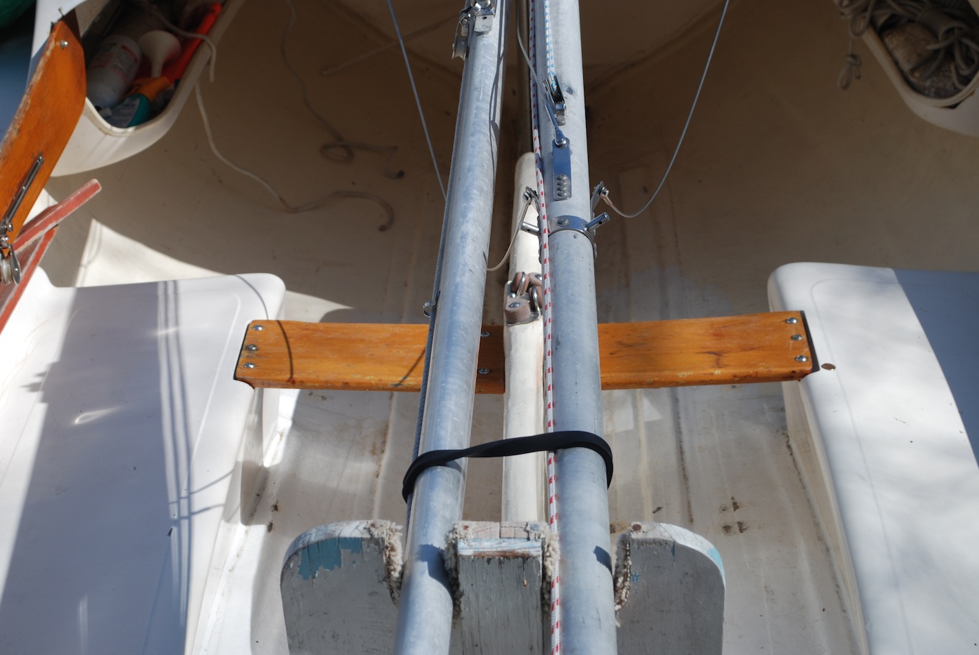

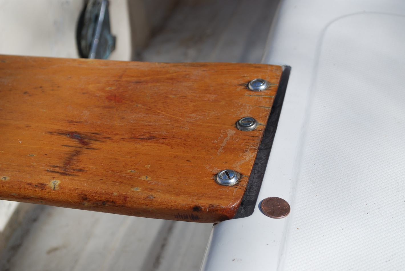

I've removed the combings and am about to remove the thwarts, but have a couple questions.
The thwarts seem to have pulled away from the slots they screw into in the seats, actually bending the screws a little. I'm trying to decide why this may have happened and if the thwarts were just not long enough to begin with, or if something has shifted / spread apart. There doesn't appear to be any damage to the centerboard trunk or the seat, but the screws going into the seat have definately bent. The port side seems to be in better shape than the starboard. This HAS been this way since I bought it, but I have essentially just been trying to ignore it and pretend like it doesn't mean anything bad. Now that I'm about to remove them, I worry that the hull may relax more, or the centerboard trunk move more towards port, or who knows what else could happen. Should I be concerned? Should I try to "pull" things back into shape (I haven't the first idea how I would do that--come-along maybe :) The thwarts are the same length (both 14-5/8"). The thwart on the starboard side has a gap between its end and the slot in the seat of 1/4 to 3/8" increasing as it moves towards the bow. The port side has a constant gap of 3/16". Should I not worry?

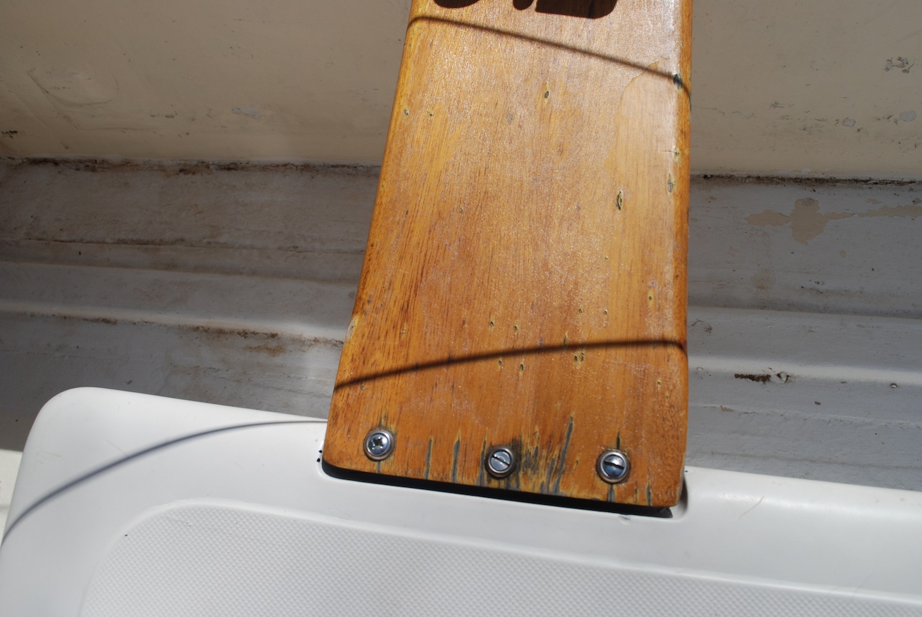

I'm also wondering if anyone has any suggestions as to a good way to fix this crack in the end of one of the combings, or at least try to keep it from spreading anymore.
Sean

Perhaps the trailer or supports were changed, or the boat sat with a lot of water or ice in it. I wonder how much clearance there is supposed to be?
For the split coaming I would either drill through (the hard way) and counter sink both the nut and bolt through it, or take all the finish off, fiberglass a layer of 4 or 6 oz e-cloth with epoxy (s-cloth is stronger but not as transparent). If it was me I would cover the combings with one of these...http://www.uscomposites.com/hybrids.html

I just did some measuring and there is a difference from one side to the other.
From rub rail edge to the centerboard trunk it measures as follows:
port side 36-5/16", and starboard side 36-5/8". I know these boats aren't precise. I'm guessing this is probably more than an acceptable difference from one side to the other and seems to account from some of the difference. The funny thing is that the thwarts measure the same and the distance from trunk to seat measures the same, so the issue must be that the trunk is not centered correctly.
Should I try to reinstall the original thwarts, or should I see about making new ones that fit the specific lengths, port and starboard? What would you guys do?

Postby GreenLake » Fri Mar 08, 2013 6:48 pm

The thwarts are intended to keep the boat together. There's an infinity of possible scenarios where sudden loads might have exceeded what the screws could hold without bending. Sitting with water on the trailer (as jdoorly wrote), "falling" off a wave etc. are all possible. The latter gives a better explanation why only one side was affected - for example if crew only sat on one side...
Have a look at the screw holes. You might decide that you'd want to dig those out, fill them with epoxy and bits of glass, and then re-drill them to fit. I would think there's no need to change the thwarts.

The cracks in your coaming are very minor and not structural. It's best if you can clean them out by sliding a piece of sandpaper in there, if you can't, it's not that big a deal, just do the best you can. Epoxy will fill the cracks and be a plenty strong repair. I would epoxy the cracks before doing the stripping. When you sand everything down after stripping they should be pretty inconspicuous. Use tape on the back side to hold the epoxy from sagging through. It's easy enough to work the epoxy into the crack by pouring it on top and then just rubbing it in circular motion the crack with your fingertip (in a rubber glove) or a credit card as a squeegee. Clamp across the cracks and don't worry if it doesn't pull them totally closed, but it probably will. If you clamp and release a couple of times that will also get the epoxy to work into the fine end of the crack.
If you start measuring symmetries on your boat you're going to find it's really all over the place. It just goes to show, that it doesn't really need to be that precise. When I redid my boat the thwarts were in tight but were different lengths by 5/8 inch. I was doing a bunch of work on the bilge, with my core project. I got measuring and I realized that the centerboard trunk was not in plumb with the mast by about the amount the thwarts were off. Actually, the trunk didn't even line up with the keelson. So I did straighten that out. However, I distorted the bottom of the boat by moving the centerboard trunk without cutting it loose from the hull, so I ended up having to do extra fairing when I did the bottom side.
I do think you want the thwarts tight for structural reasons, I think it's totally possible that they were not fit correctly originally. Though, Jay might have a point about the other possibilities. The fitting at the seat end is a little bit complex, so I decided to reuse the thwarts and added a cheater piece of mahogany on the centerboard end. Epoxy again.
