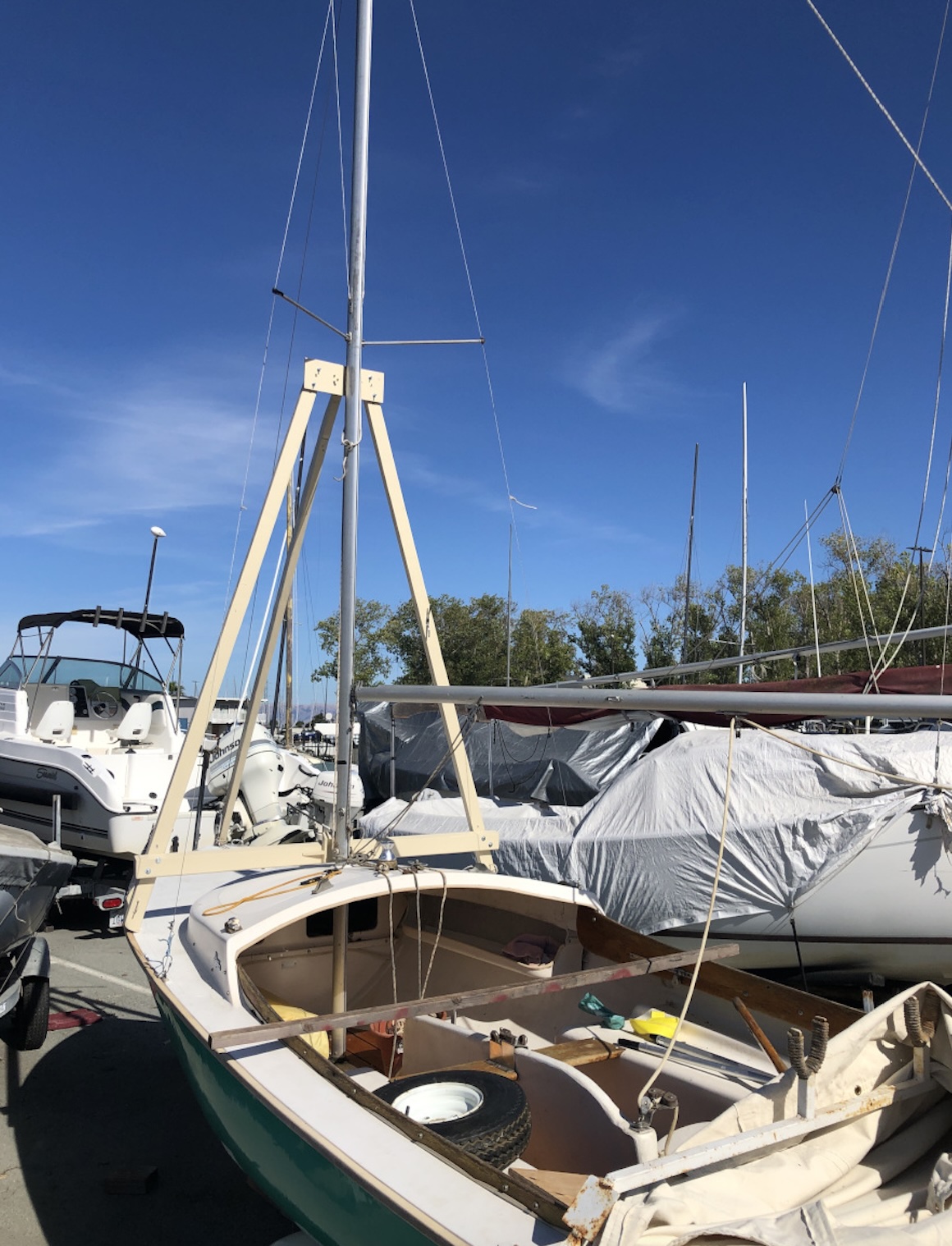

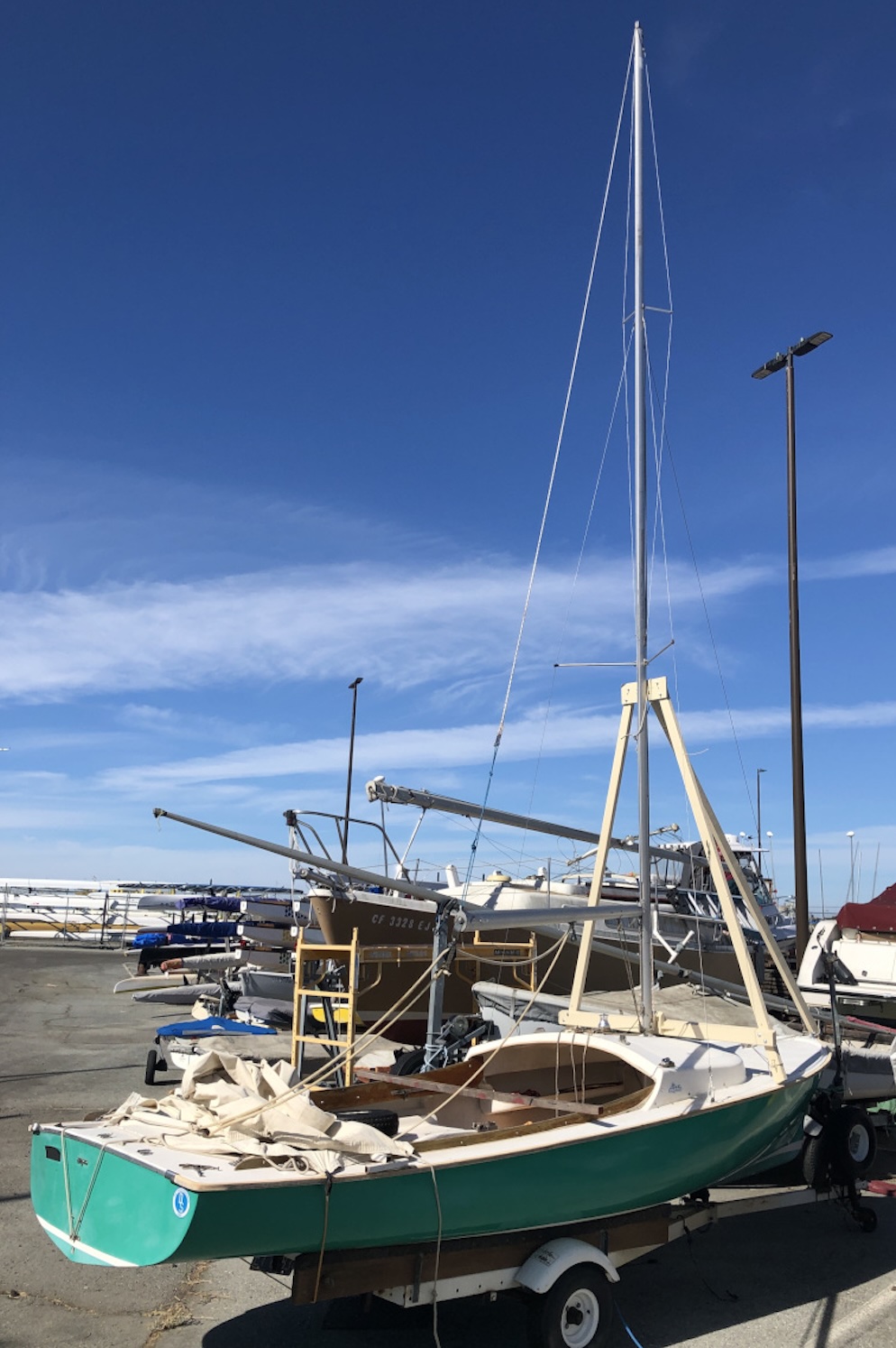

Here are some photos I took of the tripod I made. It works a treat. There's about $10 worth of purchased bolts and a couple of big box store 2 x 3's in the picture. Everything else was stuff I had lying around. The paint is lefotver house paint I bought to paint big swatches on the house before we picked the final color.
and another

Thanks for posting the pictures of your tripod. It looks super sturdy. Mine isn't anywhere near that massive and has no cross member, thus requires the legs to be pinned to the chain plates. Your cross member looks like it acts like the brace for the mast foot, a job that the hinged sleeve will do in my setup. So it looks like you have good thinking behind your design. Nice.
