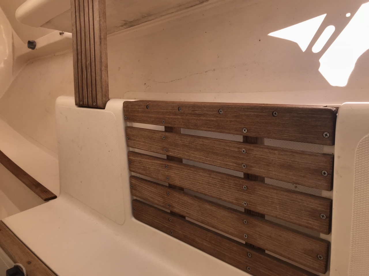

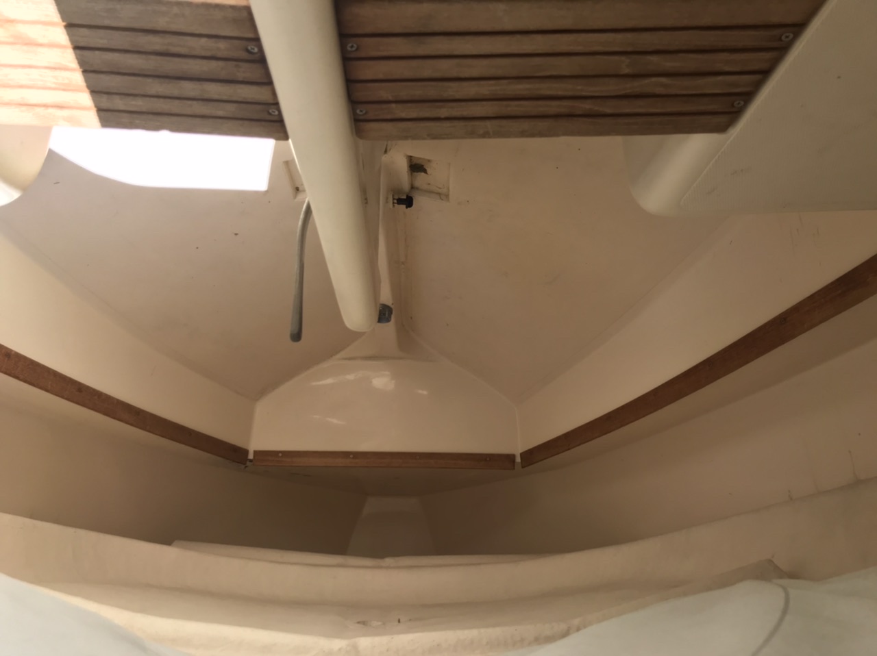

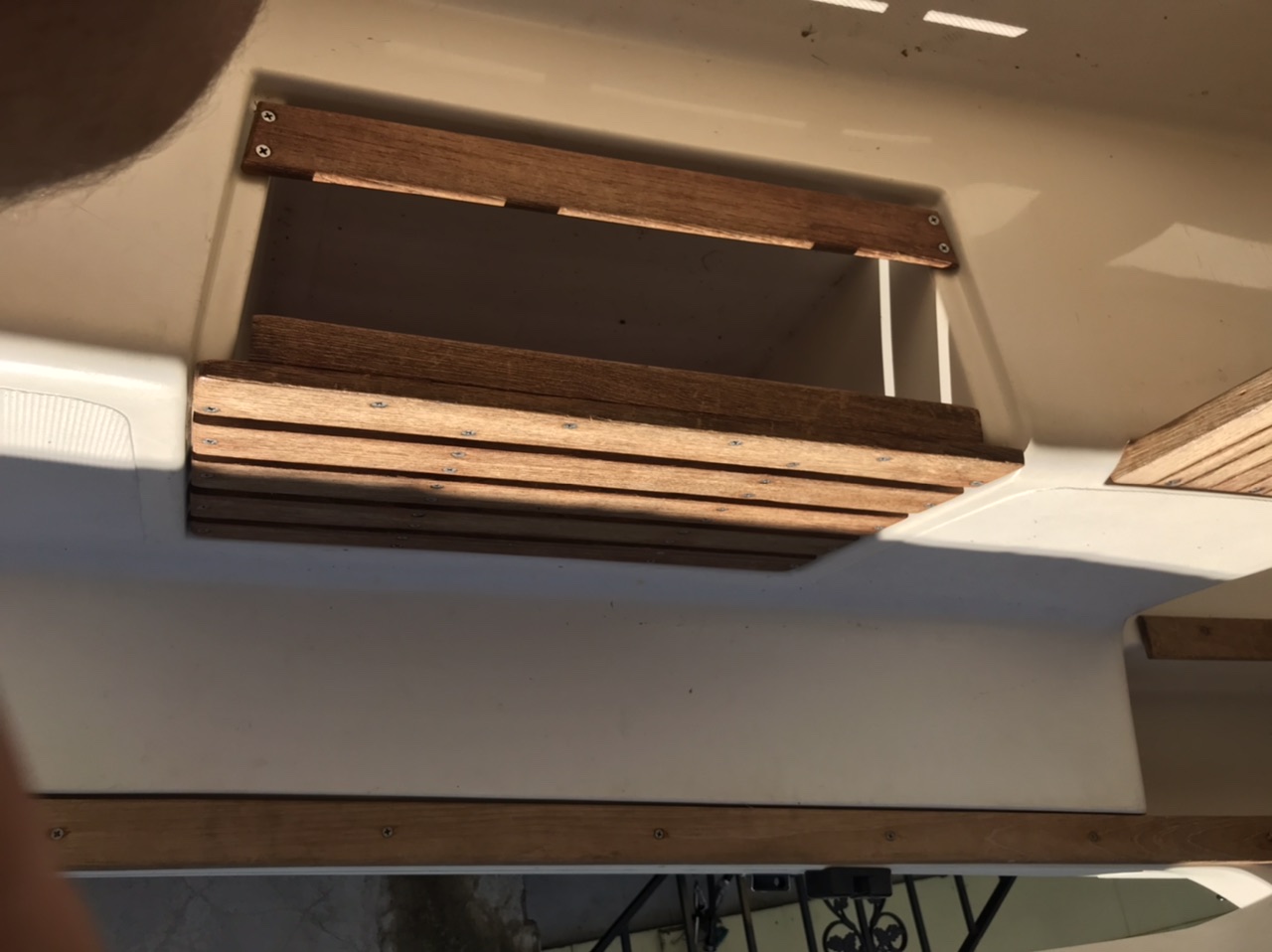

I’ve tried finding an answer in past posts, but have failed. I have an ‘87 Precision Daysailer. Is the wood trim/ seats/ thwarts mahogany or teak? How do you figure it out? I’m asking because I want to clean/ treat it, and, from reading posts, it seems like the wood type matters in how it’s treated. Any help would be greatly appreciated!

The are teak. Oil them like I do on my 86 Precision.
