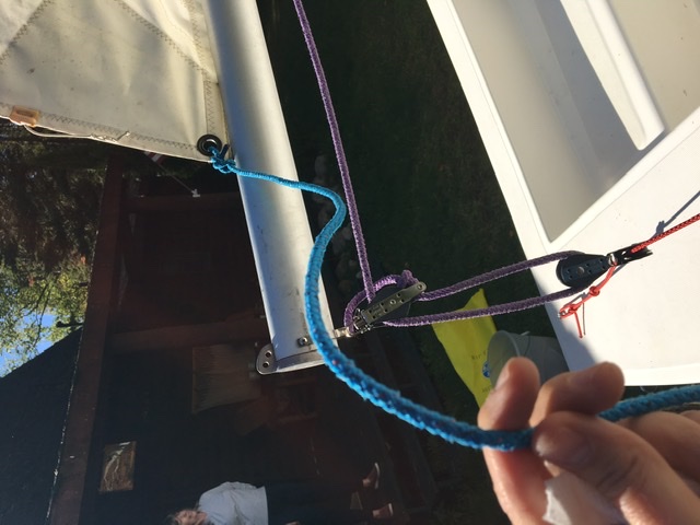

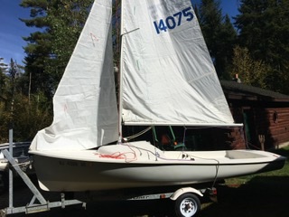

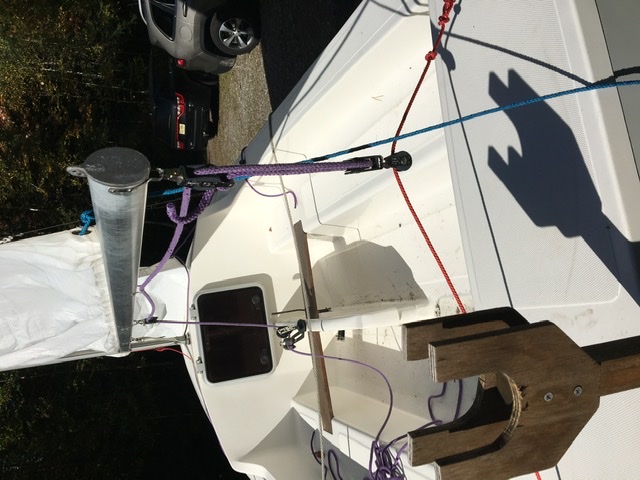

I purchased an SLI built DS1 this summer. Completed ASA101 a couple of weeks ago and recently tried to rig my boat. I’m pretty sure I’ve got a few things wrong here. Any help or advice on doing this right or improving what I’ve got set up would be greatly appreciated.
#1 looks like I need some help with my traveler set up
#2 no clew where to attach the clew outhaul (take it easy on my first attempt at sailing humor :wink: )
#3 is my main sheet set up right (I don’t think it is)
Thanks in advance for advice or direction!

First, given the hardware you have; I don't see anything that looks incorrect with your traveler. You may experiment with leaving it longer or shorter, but given the hardware you have that would be the way to set it up. Your mainsheet is also rigged as it should be.
The outhaul is supposed to go through both of the holes on the end of the boom (and back once more through the clew, all for getting a bit more purchase). After the outhaul comes out of the second hole at the end of the boom there should be a cleat somewhere along the boom to tie it off. If there's none, you could simply start by tying the outhaul to itself. A bit crude and doesn't allow for adjustments under way, but gets you on the water.
Anyway, I'd start by just looping clew-lower hole-clew-upper-hole then tighten and tie the outhaul to itself. Then go sailing!
