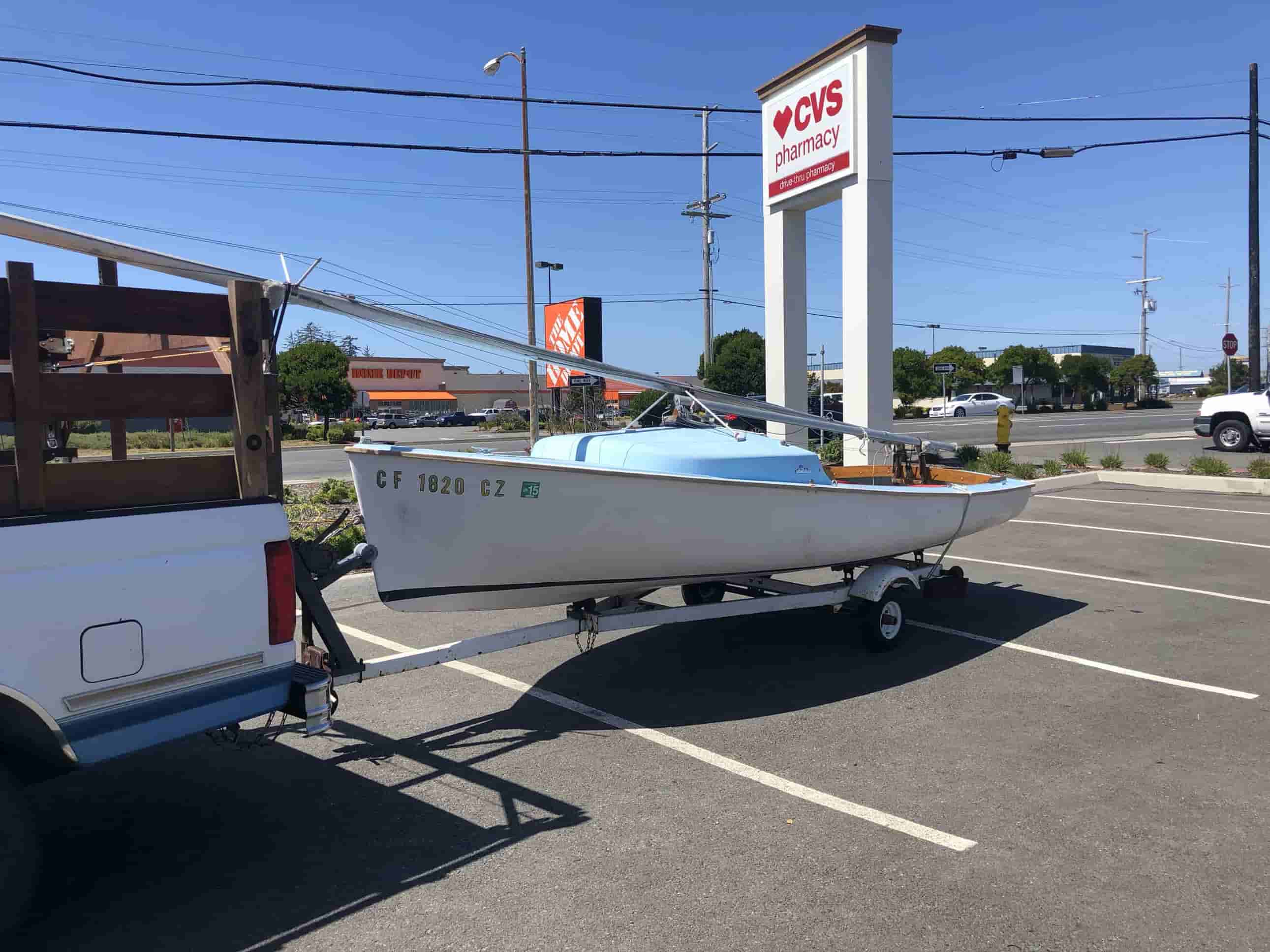

...which leads me to a question about your boat picture. I noticed the spreader bars are facing down and resting on the deck. I try to keep mine from resting like that in case it breaks them. Are the spreader bars strong enough that I shouldn’t worry about it?

@Paddyt: as long as the spreader brackets allow them to swing freely in that direction there shouldn't be an issue. Mine are definitely resting the same way, except that in my case I rotate the mast 180 degrees. Originally so the jumper struts would point down, making the mast a straight support for a tarp. Lately, I've removed the diamond stays and jumper struts (collective wisdom here is that they aren't needed) but didn't bother to take off their support brackets. So I still need to rotate the mast.
Spreaders of the original DS1 configuration are really sensitive to being knocked in a vertical direction (along the direction of the mast). I've lost one during mast raising when it snagged on something. I did jury rig something that allowed me to go on the water, but when I lost the replacement the next week for a variation of same, I made the jury rig permanent. It consists of bending plastic strips cut off from the tails of a couple of beefier zip ties in a U shape so they hold the spreader against the pin in the bracket. Then snugging these to the end of the spreader with the working parts from the same zip ties (and snugging them really well). Finished off with electrical tape for UV protection.
This jury rig has now held for several seasons. Under load, the spreader is in compression, so as long as it is held against the pin (and can't slip past it) everything's fine. The rury-rig repair itself isn't load bearing. The shrouds will determine the vertical angle of the spreader (when tight). My setup allows the spreader a bit more movement when not under load with the rigging slack. That's apparently the key to its resilience: it gives a bit, so nothing breaks.
