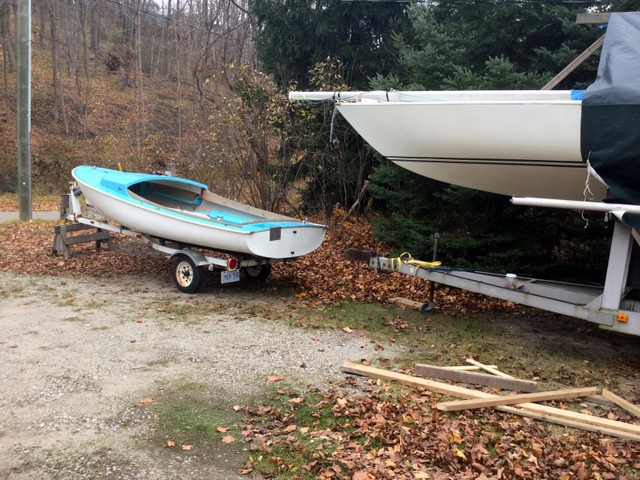

Picture of Flutterby
Postby Flutterby » Wed Nov 21, 2018 4:26 pm

Welcome to the forum. I merged your posts so people will find the picture with the description.
Definitely a DS1. Do you have a builder's plate showing the year?

OK; if that is original, the sail number would fit the date range and the deck color fits the early mid 60's. My '63, now repainted, had that color gelcoat for the deck.

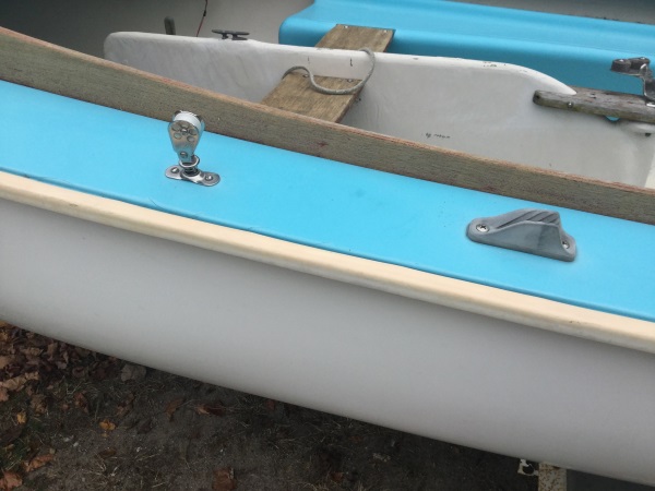

One thing that seems to be original is the Jib sheet. It has a turning block on the side deck with a jam cleat about 1 foot behind. No modification to lead jib sheet through wood coaming. This would be very hard to sail with. There is a horn cleat on the centerboard house, it would work as a set it and forget it basis :)

Are you sure that these aren't spinnaker blocks?
The horn cleat on the CB? I have that as well, but not sure what it was supposed to secure. PO did not use it for jib sheets, but his cleats were aftermarket (the tracks and fairleads themselves were original).
My DS has a molded in round spot in the side decks that was intended for some turning block. In fact it was factory drilled, but then the holes filled with matching gelcoat. Also not sure whether that was a place to mount spinnaker sheet turning blocks, or whether it was a leftover design when they had the through the coaming jib sheets.
PO for my boat never had a spinnaker rigged. I don't have forward turning blocks, but I could see how leading the spin sheets from the back to 180° blocks on the side decks with cleats a foot behind would work reasonably well.

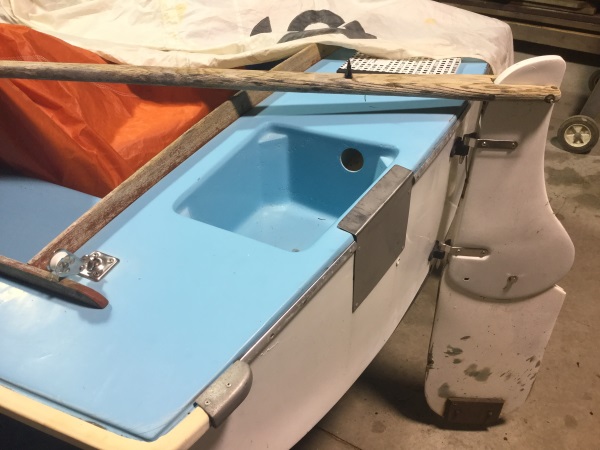

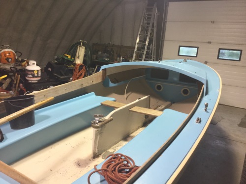

I figured out how to downsize pics. Take a look and let me know what you think.
The side blocks seem to far forward for a spin block but about the right spot for a guy. I do have the round raised spot on the side deck but no sign of being used.

Your pictures do not show whether there are turning blocks at the stern of the boat. If not, then yours isn't set up for spinnakers (the only blocks you show there is the one for the traveler/main-sheet bridle), all the spots where spinnaker blocks would be are out of frame/covered. With blocks in the back, the system could have been one of sheeting to the back, then running the sheet forward to the blocks you show, then cleating them on the side deck - that would seem to be a nice way to keep the spinnaker sheets out of the cockpit. Our sailing conditions rarely call for cleating either sheet or guy, so I just run them directly into the cockpit from the blocks in the stern - placed forward of the stern docking cleats. That's not 100% ideal as they tend to get sat on or trapped between someone's back and the coamings. So, seeing your post, I could imagine using them as described to good advantage.
On a DS it would be untypical for people to rig double spinnaker sheets/guys, so if you wanted to use those blocks for a guy, it would have to be a snatch block. I believe some people do use a fixed-eye fairlead with a side opening (so it's more like a hook than an eye) and hook the guy there to get a better angle. As you race a Soling you'll know all about rigging spinnakers, of course.
You'd probably want to put tracks on the inside of your coamings for the jib sheets and to rig barber inhauls for better sheeting angle.

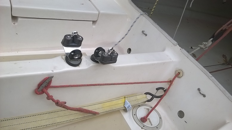

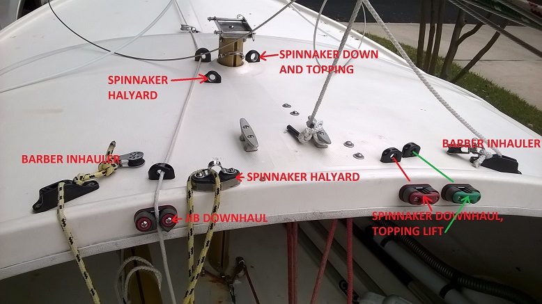

A recent post from the person who put #8011 on the market had pictures that show a typical setup for the controls on the cuddy top:
Day Sailer #8011 CB jib blocks
Day Sailer #8011 cuddy top layout
