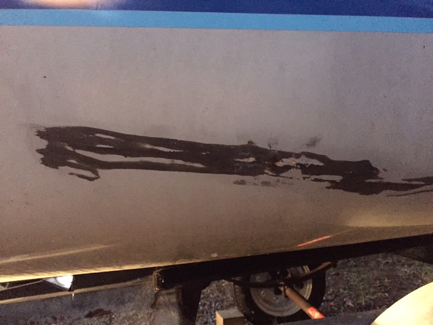

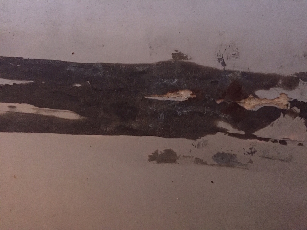

Postby bburke001 » Fri Aug 21, 2015 8:18 pm
Thanks guys for all the input - here's a couple of shots of the spot

Postby GreenLake » Sat Aug 22, 2015 12:31 am
So about 1/2" to 3/4" wide scrape with about 4" to 8" in length? Hard to tell without anything giving scale.
I'd suspect the laminate for at least 2" all around.

Postby NoCashOnBoard » Sat Aug 22, 2015 10:25 am
It's ugly but repairable. Clean out the coring like GreenLake says. This is below the waterline, you'll need the good filler from the marine store or you can order from http://www.jamestowndistributors.com/userportal/main.do?engine=msn&keyword=jamestown_distributors_marine Jamestown Distributors. They have good prices.
Get the matting to cover the top layer, it's good for sanding smooth (the straw looking stuff) for the repair. Then just paint with topside paint and you should be good to go. I would take care of this before you do try the boat out, though.
